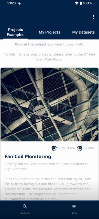

Figure 1: ST AIoT Craft mobile app main page

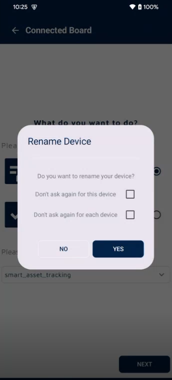

Figure 2: Rename device

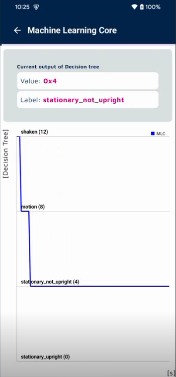

Figure 3: Machine Learning core: output of the decision tree

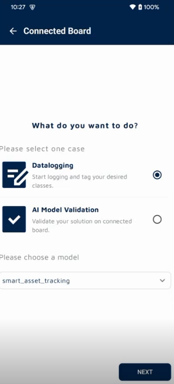

Figure 4: Connected Board - Datalogging

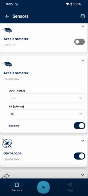

Figure 5: Enabling the Accelerometer and Gyroscope of LSM6DSV16X

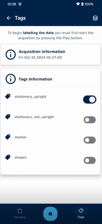

Figure 7: Labelling data

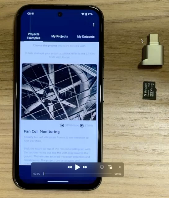

Figure 8: Read the content of the MicroSD card using a MicroSD Card reader

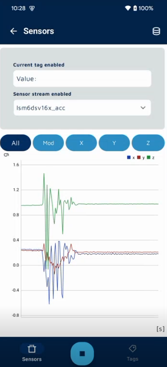

Figure 6: Plotting LSM6DSV16X accelerometer and gyroscope data with tagging enabled
