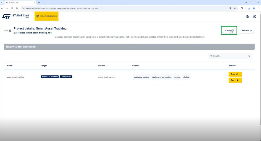

Figure 5: Project details: Smart Asset Tracking project
Figure 5: Project details: smart_asset_tracking

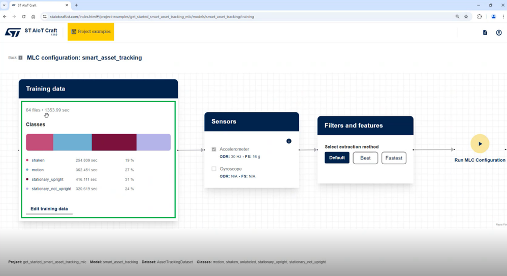

Figure 12: Train the AI model
Figure 13: Training view

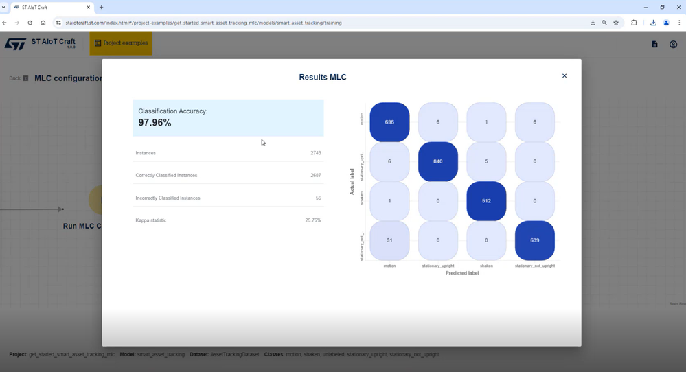

Figure 17: Expand the Results view
Figure 19: Clone the project

Figure 32: Train the model
Figure 35: Run MLC Configuration
Figure 36: Classification accuracy in fact it is 100%
