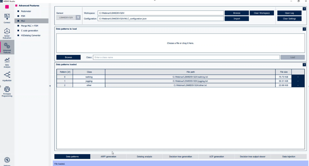

Figure 7: MLC - Data patterns

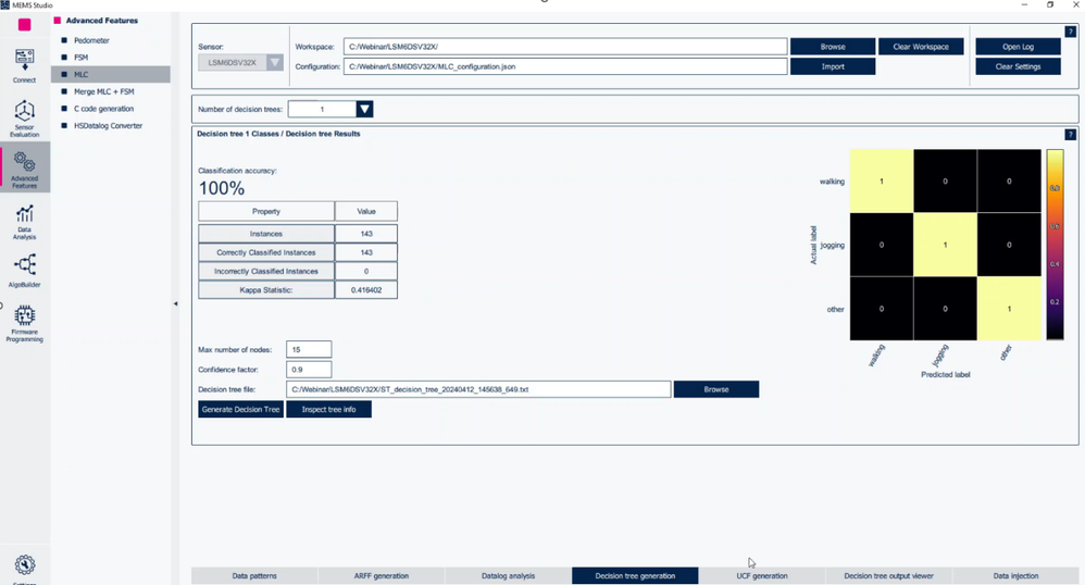

Figure 9: MLC - Decision tree generation

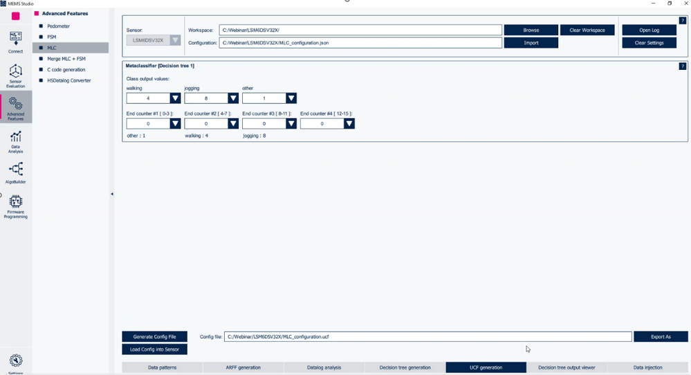

Figure 10: MLC - UCF generation

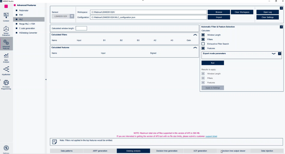

Figure 11: MLC - Datalog analysis

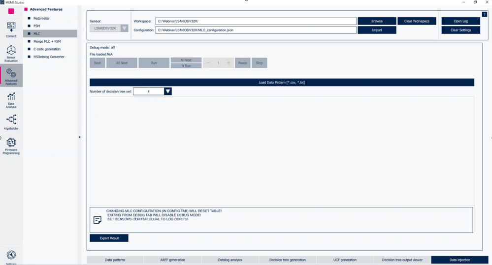

Figure 13: MLC - Data injection
