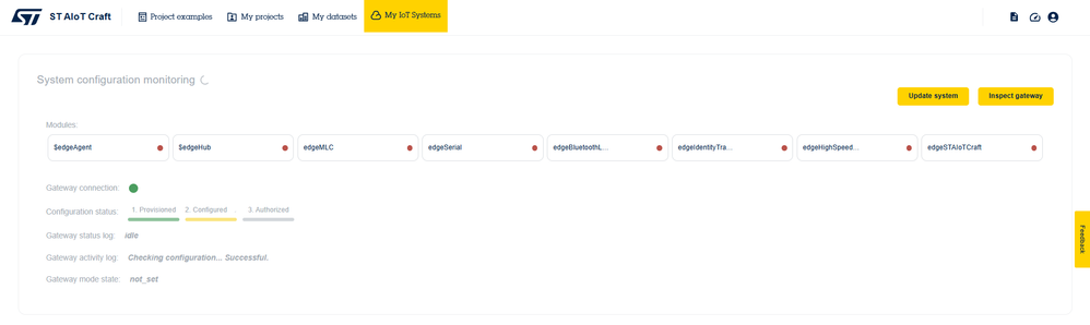

Figure 15: ST AIoT Craft – System configuration monitoring

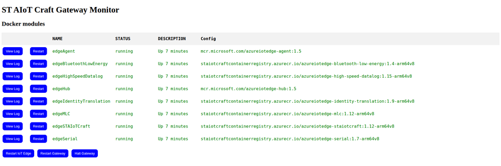

Figure 16: ST AIoT Craft Gateway Monitor – Docker modules

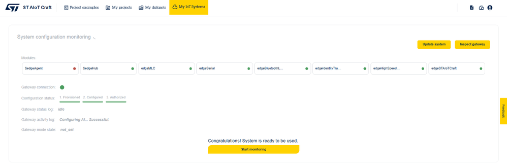

Figure 18: ST AIoT Craft – Some modules going up and running

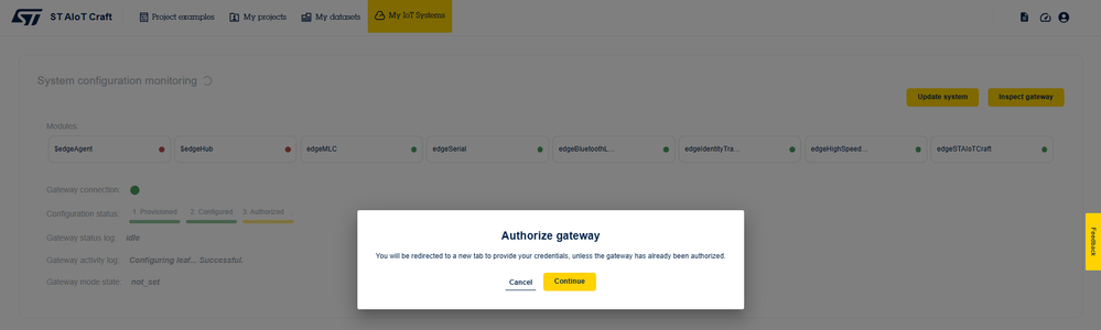

Figure 19: ST AIoT Craft – Authorize the gateway to connect to the ST AIoT Craft services

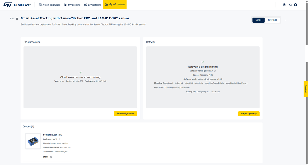

Figure 20: ST AIoT Craft – The system is ready to be used
