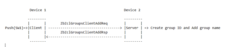

for Groups cluster, what will be the difference between your method (that of  ..\Applications\Zigbee\Zigbee_OnOff_Client_Router ) and the functions taken from the zcl.group.h file? for example, between ZbApsmeAddGroupReq and ZbZclGroupsClientAddReq?
thank you
APIs listed on my answer uses APS stack layer and could be used independently of ZCL library.
APIs located in file zcl.group.h uses ZCL library and allows to create a group cluster either as a Server or Client with the existing attributes and commands ( add, view, remove..)

okay, in my case I need to work with the ZCL library as a server, ZbZclGroupsClientAddReq command will be more useful. How does this work? My application will tell my device to add itself to the group, this order will be "stored" in the attribute corresponding to the order and so when it is received I send my ZbZclGroupsClientAddReq command?
Actually, if your device is configured as a server using ZbZclGroupsServerAlloc it can only receive commands from the client to modify the local group table.
In case of your device is configured as a client (ZbZclGroupsClientAlloc), it is able to send commands to the server requesting add, view, get group membership or remove to the group table.
ZbZclGroupsClientAddReq function is to be used from the client side in order to be added ( endpoint) to the group.
ZbZclGroupsClientAddIdentifyingReq function is to be used from the client side in order to request the addition of the endpoint to the group, when the target device is in identification mode.

For more details using ZbZclGroupsClientAddReq command, you can call this function anytime after the establishment of the network between the server and the client.
On the server side, a group ID is created based on data sent by your device ( client), then it will generate an add group response command which will be received on the callback defined in your function argument (Client side).

CH3
yes, we're in server mode, and it's the local table that we want to modify. the order we receive, do we get it via the attribute? for example, the addgroup attribute is set to 0 when no add order is received, then the attribute becomes non-null, so we've received our add order? i deduce that once we've received the order, all we need to do is create a group structure and fill it in. do you have any examples where you use the groups cluster in this way?
Thanks
Hello @CH3,
Indeed, for the groups cluster, the server has only 1 attributes called NameSupport  as mentioned in "zcl.groups.h"
As discussed previously, the server's role is to receive commands from the client and to manage the group table internally ( this is done by the stack), so no need to create or modify the group table manually.
I made an example to understand the use of this cluster with a focus on ZbZclGroupsClientAddReq function:
The client send a Group Add Request to the server by pressing SW1
On receipt of this command, the server add the group ID and the group name ( if supported) to its group table, then generate the appropriate Add group response indicating success of failure.
The response is generated on client side AddGroupCallback
The response is displayed over the UART with the status, the source adresse, and the payload ( Group ID).
Please find in attachment files for both client/server.
