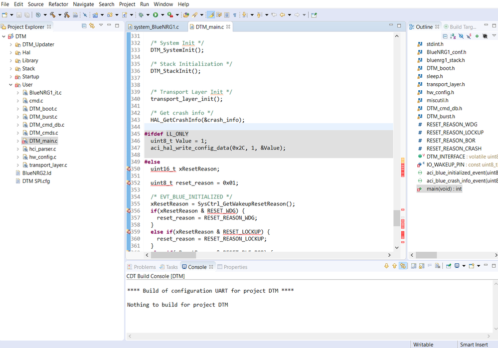

In the Wise Studio, I have open one of the BlueNRG example projects:
C:\Users\petrikas.lu\ST\BlueNRG-1_2 DK 3.2.3\Project\BLE_Examples\DTM\WiSE-Studio\BlueNRG-2
I havent changed any of the Wise Studio settings since the installation, so everything is "default". When I try to build the project that I have imported, it says that there is nothing to build.

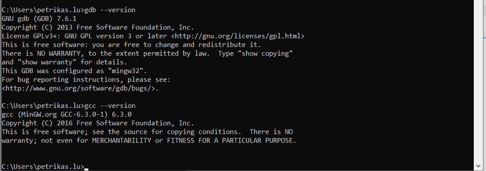

I have found out that I need to download MinGW and MSYS and thats what I did, downloaded from:
https://sourceforge.net/projects/mingw/
I have added both:
C:\MinGW\bin
and
C:\msys\1.0\bin
to PATH and confirmed via CMD:
After this is done, I restart Wise Studio and try to build the project again but exact same issue - nothing to build. I would really appreciate if I could get some ideas on how to solve this issue! Thanks in advance.

Do you have the GNU Arm Embedded Toolchain installed and set the path?
I installed below.
Downloads | GNU Arm Embedded Toolchain Downloads – Arm Developer
LPetr.1
Senior II
Hi. I have deleted BlueNRG SDK and downloaded it over again. Now works without issues. I think the issue might have been that I had open that example project via many different IDE and it messed up the project settings. Now I can build using WiSe studio
