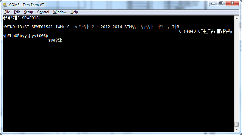

Posted on December 15, 2016 at 19:21
the problem is that my IDW01M1 shild is send a garbage with data  and I didnt find:
1. How upgrade firmware
without
nucleo?
2. How can I connect a JTAG and use with shild as evaluation board? is there available source code for flashing?
Is there any documention for support this?
Attach terminal screenshot with data from shild on power connection.
Regards,
Arthur.
Posted on December 17, 2016 at 09:40
I'm a little bit confused...
At the beginning problem was Reset Line, then we moved to Discovery board, and at the end problem is garbage on UART.
About the last point, I think Discovery is not properly set. Check clocks (System and Peripheral), and I/O levels (module's high level is 2V5).
About your questions:
- you can upgrade via UART (use an external level shifter if you don't want to use Nucleo), or send AT command to use OTA update
- JTAG is not documented as official update tool
Regards
