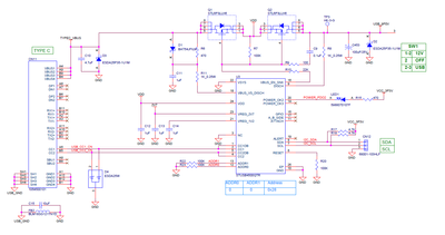

Hello everyone,
I've been working on a custom board that incorporates the STUSB4500QTR. My aim was to set it up using the Nucleo-F072RB and STSW-STUSB002. However, I'm facing an issue where the Power Delivery Objects (PDO) configuration screen won't display in my setup. Intriguingly, when the board is connected to the EVAL-SCS001V1, the PDO configuration operates as expected, leading me to suspect a potential issue with my custom board's circuitry.
I'm at a bit of a loss here and would greatly appreciate any insights or suggestions from the community. Could there be a common mistake or oversight I might be missing? Any advice on troubleshooting steps would be immensely helpful.
Thanks in advance!

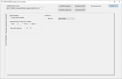

Hello everyone,
I wanted to update you on the issue I was experiencing with my custom board using the STUSB4500QTR. It turns out, the problem was due to a mix-up in the components. Instead of the STUSB4500QTR, the STUSB4500LQTR had been mistakenly implemented on the board. I noticed that the app's screen also indicated "STUSB45 L Detected," which was a clue to the mix-up.
I apologize for any confusion caused and appreciate the support.
