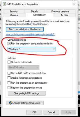

I am using STWPLLSim tool to simulate loop values for STW81200. After installing, when I start the program the following LIBRARY NOT FOUND error occurs:
java.lang.UnsatisfiedLinkError: C:lProg ram Files (x86)1STMicroelectronicsISTWaLSim_v5.31Loaderltimeresp.d11: Can't find dependent libraries
Anybody has solve this problem?

pkgev
Just ran into this problem myself.  The fix appears to run the Matlab Compiler Runtime installer "MCRInstaller.exe" from the zip in Windows 7 compatibility mode.
