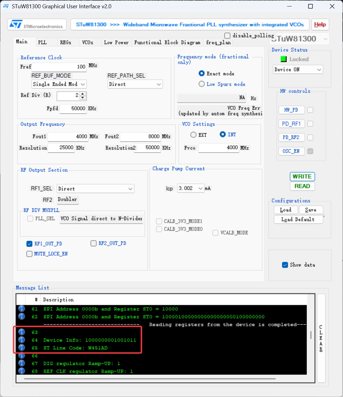

Hi.I think I solved the problem.
I checked the FTDI driver version in the device manager. It's Ver 2021.
But FTDI driver version is Ver 2015 in STSW-RFSOL003 - 2.0.
It may have compatibility issues with Win11.
I uninstalled all FTDI drivers,then restarted the system and disabled forced driver signing.
After reinstalling the FTDI driver, STuW81300GUI-v2.0 can correctly read the device ID of EVB. It can also be written to all registers, and EVB is locked
