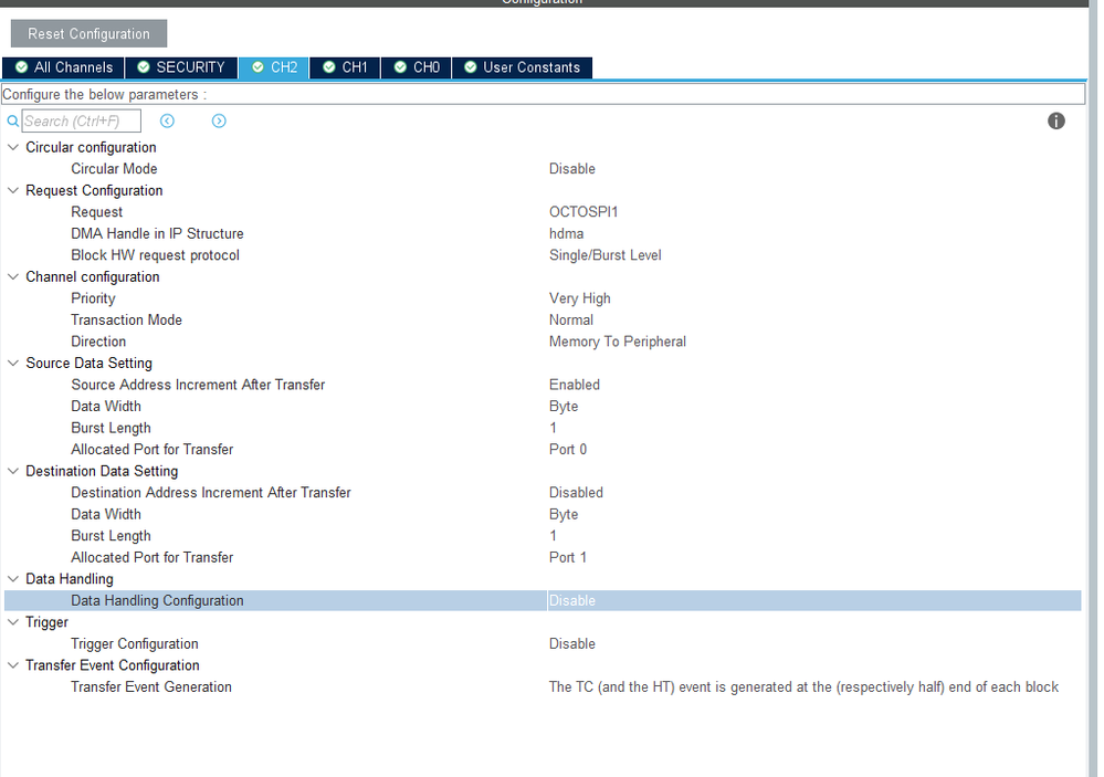

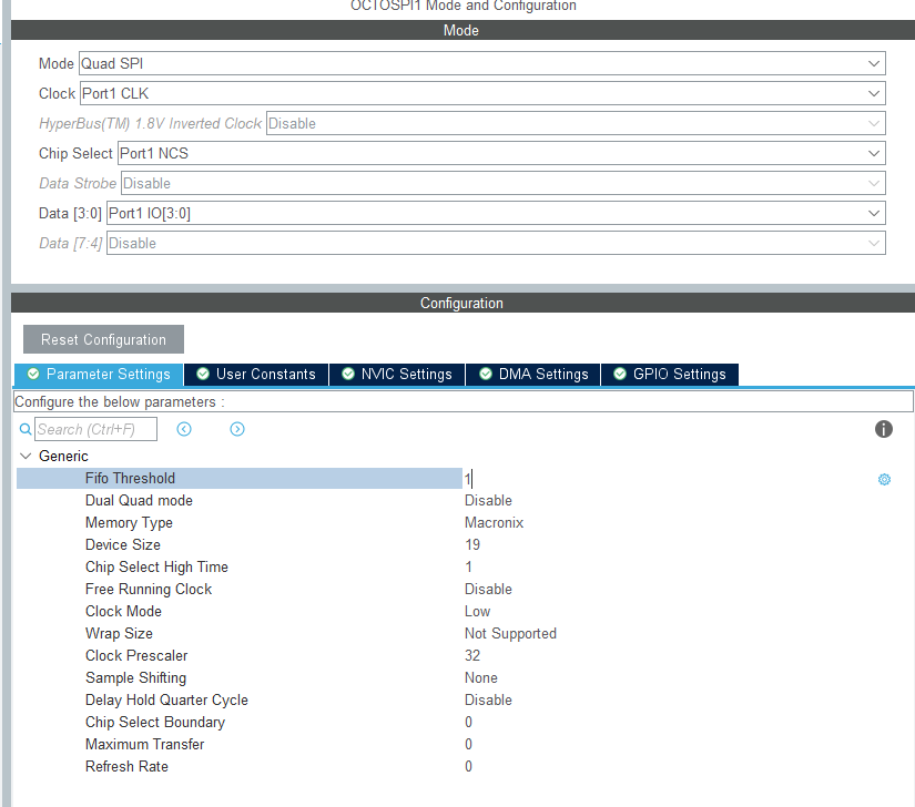

Now in the DMA, i replaced the HAL_OSPI_TRANSMIT with :
HAL_OSPI_Transmit_DMA(&hospi1, param);
I also updated the CubeMX configuration :
0693W00000WIAlVQAX.pngand for GPDMA:
0693W00000WIAnCQAX.pngTo be honnest at a certain point I tried all the possibilities with GPDMA port - direction - and so on with no success, so I kept what made more sens to me.

Ok, I dig more into it, I figured out that if datasent count is lower that 0xFFFF then HAL_OSPI_Transmit_DMA works as expected. But in the case of sending more data it "breaks".
I made a bug report and waiting ST response on that, here with minimal code to reproduce:
https://community.st.com/s/question/0D53W00002DWC4xSAH/halospitransmitdma-not-working-for-nbdata-0xffff-
