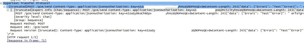

florian239955_st
Posted on March 25, 2016 at 09:30
Hi Jerry,
thanks for your example.
I tried a lot, but don't get the page to accept the content lenght:
I send:
AT+S.httpreq=android.googleapi.com,80,388
and after that I send the post data:
POST /gcm/sendAccept: application/jsonContent-Type: application/jsonContent-Length: 243 ... followed by the JSON content
I receive always the answer, that the length is required...
HTTP/1.0 411 Length Required

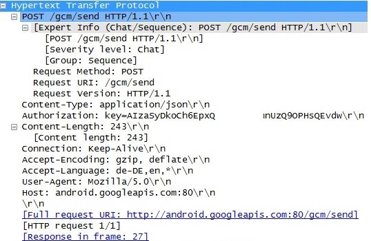

florian239955_st
Posted on March 25, 2016 at 18:11
Hey J,
I played a little bit with wireshark.
I sniffed the packets send by my PC program, that works with gcm. I've seen there, that between the Content-xxxx messages are   \r\n.
So I tried this also with the SPWF. But when I have there  \r\n between e.g. ''Content-Type'' and ''Content-Length'', I didn't sniffer any HTTP packets any more, just tcp packets.
Without the  \r\n, I also sniffer HTTP packets send by the SPWF.
Do you have an idea why didn't sniff any HTTP packets when I have the  \r\n in my header?
Thx & regards,
Flow
Gerardo GALLUCCI
Posted on March 29, 2016 at 11:03
Hi Flow,
no idea for this. Bytes you see in the wireshark, are the ones you fill in the module by HTTPREQ command. Module does not append nothing by itself.
Second picture shows a ''Truncated'' request. The string ''POST something HTTP/1.1'' is really ''POST something other...''. Seems like string provided to HTTPREQ is not well formatted. Try to sniff the UART link between module and external MCU. Try also to put a delay between HTTPREQ command's <CR> and following payload (request string), just to be sure that characters are not lost over serial line.
Let me know.
j
