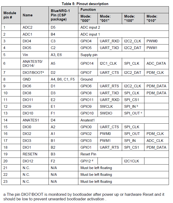

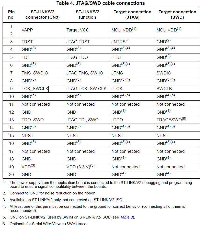

i have connected the following pins from the SPBTLE-1S to the ST Link V2.
SPBTLE-1S | ST LInk V2 JTAG connector
Vin (pin 5) | VDD (pin 19) & VAPP (pin 1 & 2)
GND (pin 8) | GND (pin 16 & 18)
SWCLK (pin 12) | SWCLK (pin 9)
SWDIO (pin (13) | SWDIO (pin 7)
RST (pin 19) | NRST (pin 15)
I have attached pictures of the pin descriptions from both modules.
can anyone tell me why i dont get any connection/communication to the BLE-module?

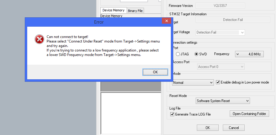

i get the error message as shown in the picture below. And i use the settings that is shown in the picture.
Any suggestions ?
