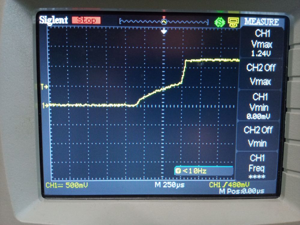

Hi Macias,
Sorry that i couldn't find an issue for the posted code.
MC_STATE0 0xe9 means that S2-LP is setting up synthesizer, it's ready now, and XO is operating.
It seems that there is something wrong trying to lock for TX.
Could you review the circuit, especially for the capacitor on VRSYNTH ?
Possibly if you could try to add some delay before S2LPCmdStrobeTx() ?

I create switch based board to select commands on nucleo board. I'v got 5 switches:
1 - init S2LP registers,
2 - check MC_State's,
3 - send frame (send fifo bytes and tx strobe),
4 - set SDN pin,
5 - reset SDN pin.
Now the first sequence: 4,5,1,3,2 and the board stuck with MC_State0 = 0xE9 (atachment 1-BAD.jpg is the voltage on VrSynth). Then I do the same sequence (board have still a power supply) and then the board work good and the MC_State0 = 0x01 (in the TX_Sent isr arrived), the voltage in Vrsynth look's rising faster(2-good.jpg).

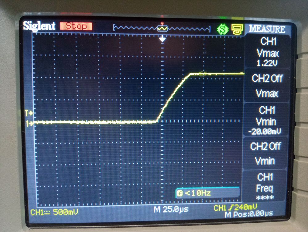

As you see here is a difference with load cap time and the shape for a first run.
Here is a second start:0690X00000ApPcRQAV.jpg
Thank for a replay.
Winfred LU
Please note that SDN hold pulse width (Thold) has to be larger than 1 ms (switch 4 ~ 5)
and the Rest pulse width (Trest) has to be larger than 2 ms (switch 5 ~ 1)
Refer to datasheet Figure 8.

Hi, the SDN pin is connected without any diode's like it's in a STEVAL-FKI433_V2. I add a delay to initial SDN and SRES strobe:
	SdkEvalSpiInit();
	SdkEvalEnterShutdown();
	vTaskDelay(10/portTICK_RATE_MS);
	SdkEvalExitShutdown();
	S2LPCmdStrobeSres();
	vTaskDelay(100/portTICK_RATE_MS);
