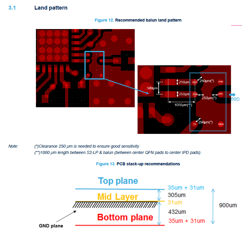

S2-LP to BALF-SPI2-01D3 connection 1mm Thickness 2 layer PCB.
18-Team
The trace thickness and gap in the datasheet for connection from S2-LP to BALF-SPI2-01D3 are given according to a special 4 layer stackup. What should this trace thickness and gap be on this connection 1mm thick 2-layer PCB? Dielectric constant = 4.3.
