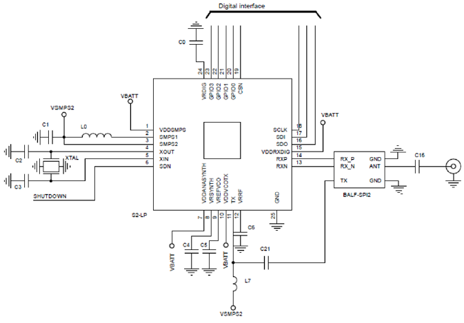

Hi
I have my custom RF board using S2-LP and balunBALF-SPI2-01D3 (
/external-link.jspa?url=http%3A%2F%2Fwww.st.com%2Fcontent%2Fccc%2Fresource%2Ftechnical%2Fdocument%2Fdatasheet%2Fgroup3%2Fe9%2Fff%2Fcd%2F1e%2F4f%2Fdd%2F49%2Fb4%2FDM00417488%2Ffiles%2FDM004174pdf%2Fjcr%3Acontent%2Ftranslations%2Fen.DM004174pdf
) and my custom board follows the evaluation design given in the balun data sheet. I am having problem with it:
The host controller communicates fine with S2-LP over SPI (I can see the expected signals on oscilloscope for SCL, SDI, SDI and CS). Also SMPS 1 and 2 (pins 2 and 3 of S2-LP) show expected waveforms. But there is not signal on TX pin. Can anyone help me please?

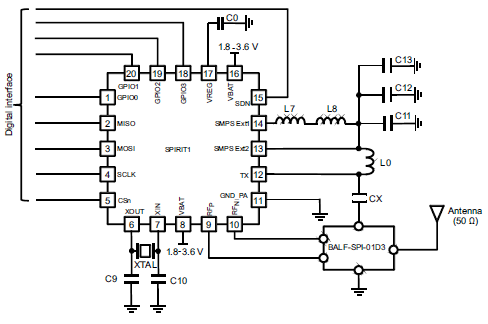

But it seems to me that
components forBALF-SPI2-01D3 would be simpler.
BALF-SPI-01D3 has 2* L and 3* C connecting to SMPS Ext1 while
BALF-SPI2-01D3has 1* L and 1* C connecting to SMPS.
This is schematic for BALF-SPI-01D3:
And this is the schematic for BALF-SPI2-01D3:
Best Regards,
Winfred
Anton Olofsson
Posted on April 12, 2018 at 13:55
Hi Silas,
Hope you are making progress!
Have you double checked that TX-line between S2 and BALUN  is connected to SMPS2 as seen on p.5 here (VSMPS2):
http://www.st.com/content/ccc/resource/technical/document/datasheet/group3/e9/ff/cd/1e/4f/dd/49/b4/DM00417488/files/DM00417488.pdf/jcr:content/translations/en.DM00417488.pdf

Hi Anton,
Thanks for your thoughts and suggestion! Yes I am following exactly the same schematic - the one in the updated version of balun reference manual.  I have actually compared the voltages between the S2LP Eval board and my board and they are similar. The one with discrete components also behaves similarly, get a very flat output and not a nice spike @868Mhz on spectrum analyzer. Both the versions are two layer pcbs and also I did not follow exactly the transmission tracks length guidelines, I was following the older version. But after that test, I have designed 4 layer pcb and have taken all possible care to follow the guidelines. My samples boards should arrive in couple of days. I am very much hiopeful this time  Will soon post the results!

Hi All
I received my sample boards, this time with 4 layers and guidelines followed exactly, assembled one and tested!! Works perfectly fine!!   I compared with the S2LP EVAL board for the performance, and seems to give me almost comparable results! Both modes TX and RX work good.
