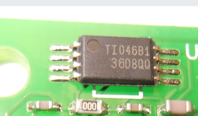

the eeprom am using is
TIOB46B1
you will not find datasheet for it
but i used to read it or write with these steps and discribtion

Lexmark toner chip Ti046b1
here:
https://www.eevblog.com/forum/projects/lexmark-toner-chip-ti046b1/
