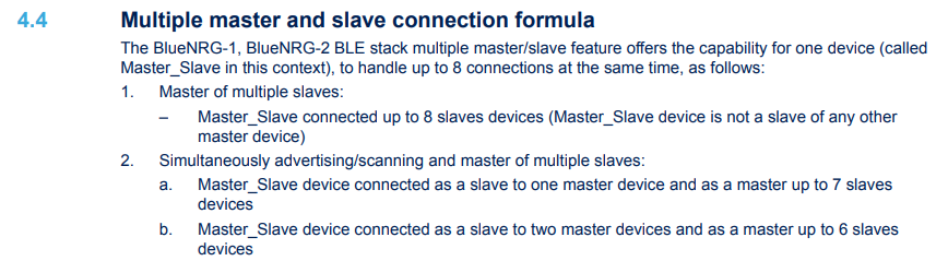

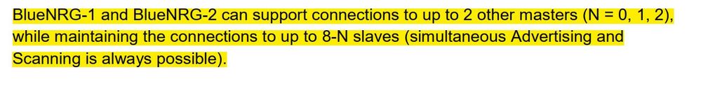

0693W00000NsYwyQAF.jpg@rsilva​ The documentation about BlueNRG2 say that.
0693W00000NsZ35QAF.jpg I don't know if it has any limitations.

@rsilva​ : ARami.1 is using BleuNRG-LP whereas you are using BleuNRG-2.
BlueNRG-2 is limited up to 8 simultaneous connection as per below :0693W00000NsbqiQAB.pngThis is an extract from PM0257 : BleuNRg-2 BLE stack programming manual - section 4.4
Regards,
Sebastien.
