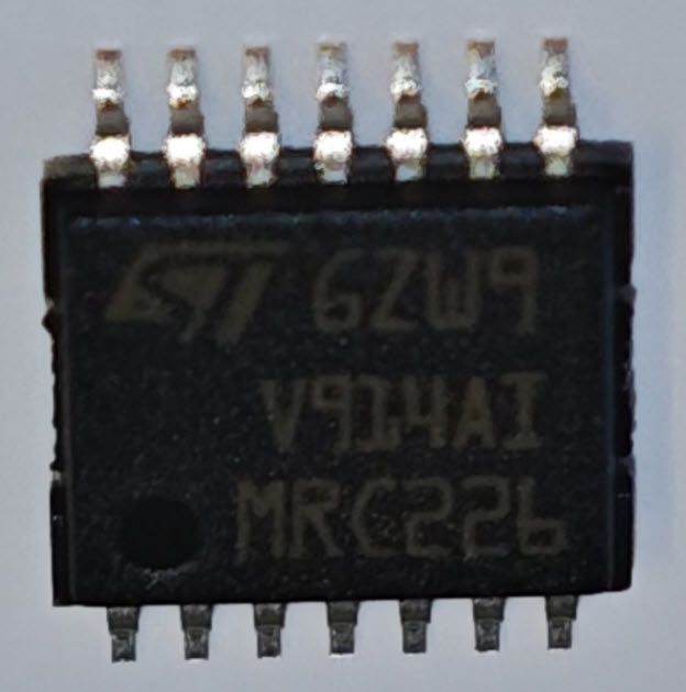

Hey,
the text on the ST ic is:
gzw9
v914ai
mrc226
did anybody know the type ?
thanks a lot
AScha.3
Case?
Pins?
Real pic ?

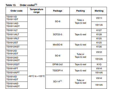

Probably : TSV914ai
see:

AScha.3
Case?
Pins?
Real pic ?
Probably : TSV914ai
see:
sry, its the 1st question ;)
its probably a TSSOP14
