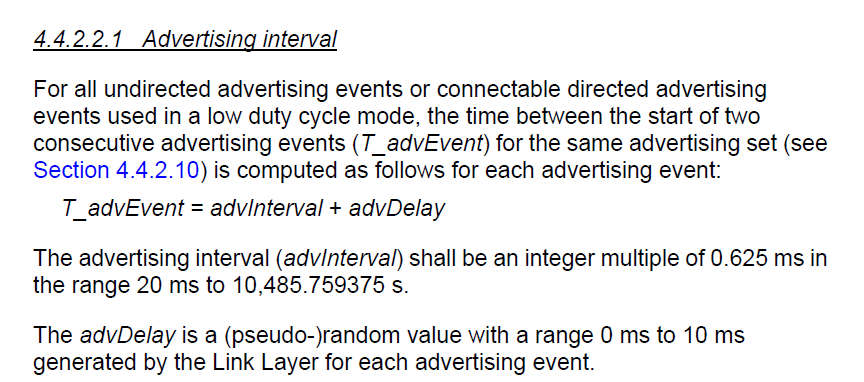

Hello Sebastien,
There is an interpretation error from ST. The Core spec 5.2 says 10485 seconds and not 10 seconds.
Regards,
Jean

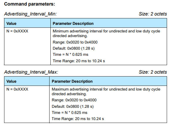

2022-09-15 1:07 AM
Hi @jbie ,
Agree maximum is not exactly 10sec (this is a common language we used).
Maximum allowed according to BT core spec is 10.24sec for the legacy advertising you are using.
See : BT core spec 5.2 - §7.8.5 : LE Set Advertising Parameters command
The 10,485 value you are mentioning refer to the "extended advertising".
Coming back to your point, this maximum of 10.24sec is indeed supported by BlueNRG-LP stack in accordance with BT core spec.
You can test ADV_interval = 16384 (10.24sec = 16384*0.625)
You can check our "Beacon example" from SDK for more details.
Regards,
Sebastien.
