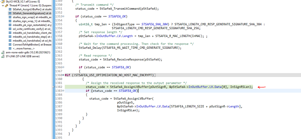

2023-03-22 3:50 AM
Hi @Benjamin BARATTE
Thank you for the immediate response.
I tried your suggested method and didn't generate key pair and CSR for slot1.
I hardcoded certificate in the flash.
Passed STSAFE_GetMbedPK_ECDSAInfo_1 to pk.pk_info.
The handshake went ahead and gave error when StSafeA_GenerateSignature was called from stsafe_sign_wrap_1().
I have attached the debug session image for the reference.
The highlighted line 1382 returns "STSAFEA_INVALID_RESP_LENGTH", upon more inspection into that function, I see the pDestLVBuffer->Length = 48 but ExpectedLen = 0;
Please suggest.
Thank You.
@Benjamin BARATTE
Edit: I figured out g_key_1_size was initialized to 0 which should have been 48 as I generated SECP384 key. Now the handshake worked.
Going to try out saving the certificate into the STSAFE flash and will update you soon.
Thank You.:folded_hands:
2023-03-22 8:28 AM
Hi @Community member,
Effectively, the g_key_1_size shall be kept by the application in order to get the correct key size of the private slot 1.
As the key is generated by the application, the application is best place to reset the global variable at each start up without regenerating a key.
Best Regards,
Benjamin
