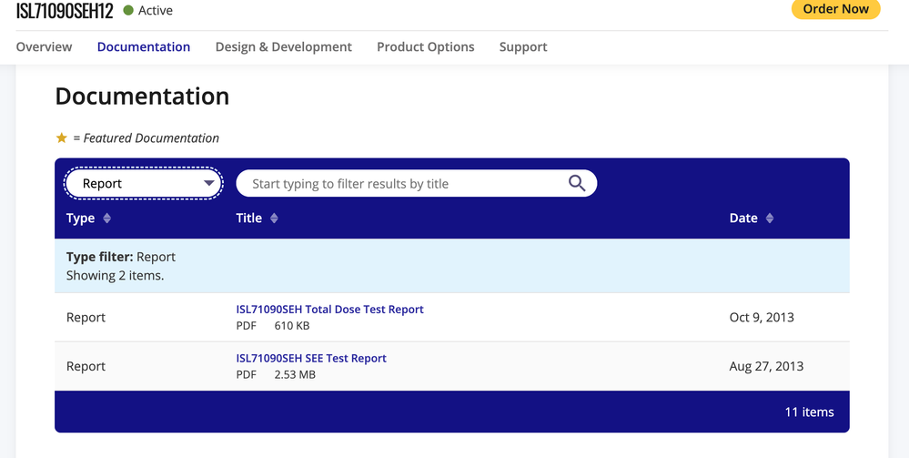

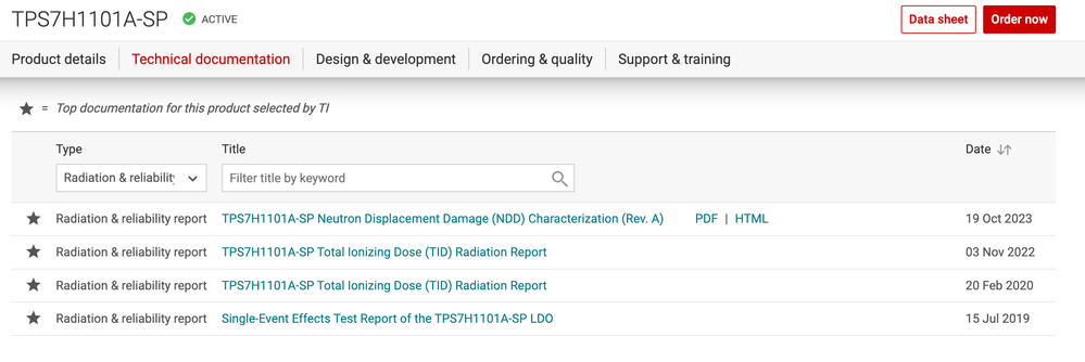

I mostly want to kick up a bit of a fuss because it's general practice to have this data on the website along with the data sheet (see examples below from TI and Renesas). ST is one of the few companies that doesn't do this.
