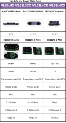

2024-07-25 7:27 AM - last edited on 2024-07-25 12:21 PM by John E KVAM
These are the parts from www.hornix.com.tw - the first 2 have flat pieces of glass that fit tightly over the sensor. Click on product to see the full list - near the bottom of the page.
The one on the right has an opaque barrier that completely prevents crosstalk - but it's more expensive to mold.
(Hornix and ST cooperate but have no financial arrangement.)
They are in Tiawan - so give them a bit to respond.
- john
