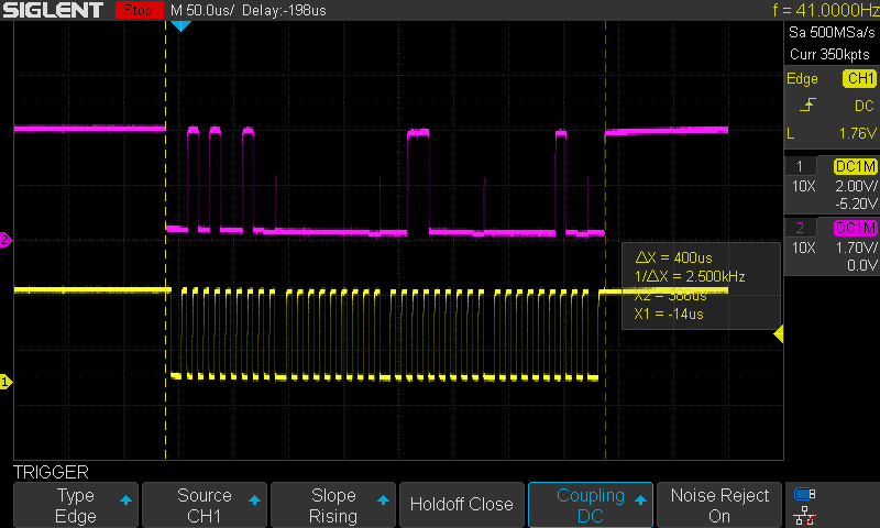

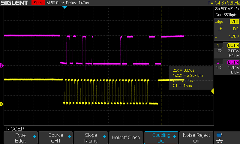

Hello, I solve a problem with writing the value to the register of sensor VL53L1X. It is the main purpose, why the sensor doesn´t read distance because the init state is invalid.
For example, I tried to write the value 0x2 to the register 0x30 on the Arduino board and then on the BluePill board with chip STM32f103C8T6. On the Arduino, it worked, but on the STM didnť work.
I´m adding PrintScreens from the oscilloscope with the same message in Arduino and in STM for comparison. The messages are different in length and count of peaks. It looks like, then STM has an incorrect SCL.

The problem with writing values ​​to the sensor registers was caused by a bad BluePill board. The fourth byte of the message was never sent (you can see it at the PrintScreens from the oscilloscope), the clock always dropped after the three byte.
When replacing the board and using the same I2C bus settings, everything worked.
Beware of non-original boards from Aliexpress, they may contain this error.

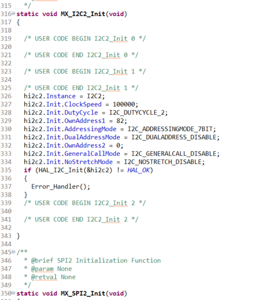

toman
@John E KVAM​ thanks for you answer. The I2C mis-configured is possible. I´m adding the actual configuration.
0693W00000Y7egCQAR.pngReally long wires are not the cause of this problem. I use the same wires for testing on the Arduino board and it works.
Tomas
