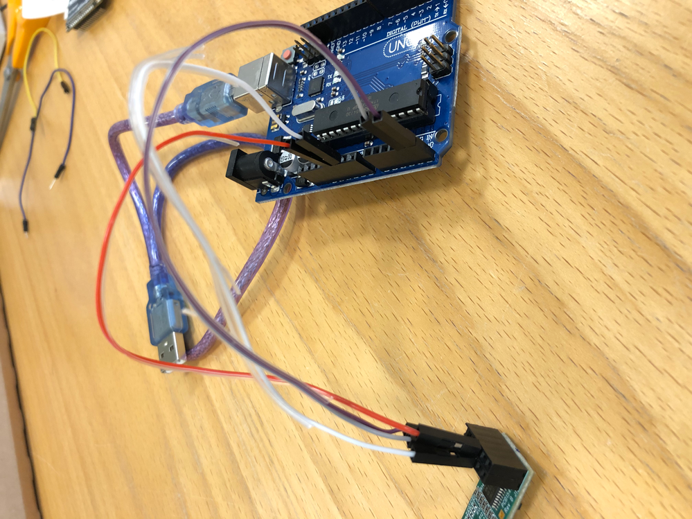

I can't find out how to connect my sensor to an arduino uno. Tried both with sample codes from SparkFun and i2C example code. It is connected in the following way:0693W000008GAdCQAW.pngSCL -> SCL
SDA -> SDA
GND -> GND
VDD -> 5V
I also tried with 2K ohm pull-up resistors, but didn't work.
I hope someone can help :)

John E KVAM
VDD has a max of 3.6.
5V is completely out of the question.
There are a good dozen variants of tiny carrier boards. Pololu, Sparkfun, and enen ST make them.
From the picture it looks like that's the green satellite board from ST and it does not have any voltage regulators on them.
So 3v3 is the right answer.
The VL53L1 doesn't really do very well if you over-voltage it, so I'm a little worried.
if you need to buy another, you can by the ST satellit board that does NOT come with the X-Nucleo-53L1A1.
Those are blue and do have voltage regulators on them.
Good luck.

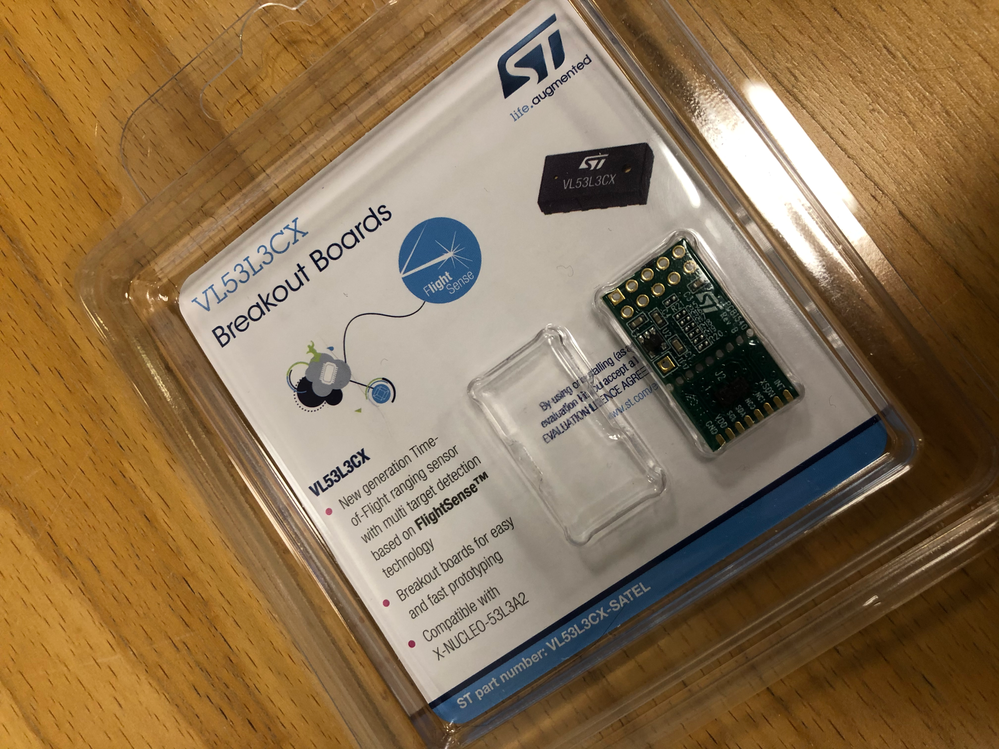

Hi John
Thank you very much for the quick reply!
I thought the satellite board had regulator as seen in the documentation from 5v to 2.8 (https://www.st.com/resource/en/data_brief/vl53l1x-satel.pdf), but i also tried 3v3 without any luck. I thought this was a carrier board and the voltage regulator can be "broken" off at the dotted line.0693W000008GB5LQAW.png
John E KVAM
We sell those two ways - with regulators and I2C level shifters and without.
The sensor itself only needs 3v3, ground and I2C clk and data. Although there is an interrupt line you can use.
Look on the back side of that board. Are the chips stuffed?
If so you should be good.
otherwise the most common mistakes are reversing the I2C clock and data or using too long a wire.
If you are going to use anything except 3v3 please use the entire board.
You need the regulators.
Another issue is that this device has 2-byte address. (Most I2C parts have a one-byte address.)
If you only send one byte addresses, the chip will not respond until it gets the second address.
The boad you have should work.
the easy thing is to try to do a read on I2C address 0x29 (write address 0x52/ read address 0x53)

Hi
I not too experienced in electronics, but got it to work with the i2C scanner by adding wires to the "main" board (the small one) from 3v3.
Next step is to find a code in Arduino that utilised i2C
