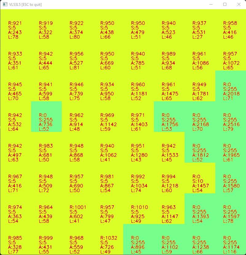

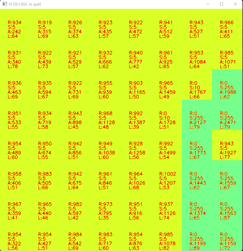

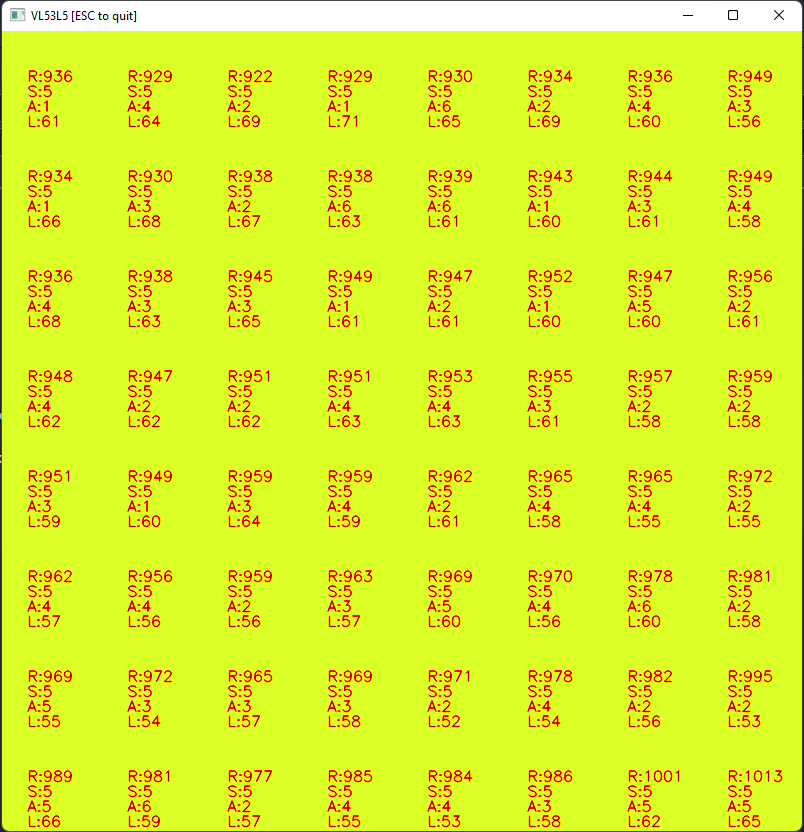

I also found that the halogen lamp create similar effect of the sun. I place the sensor at 950mm of a wall and I light up my 500w halogen lamp and point the lamp to the wall.
here a screen shot off 1 sample before lights up the halogen lamp
0693W00000KcrTXQAZ.pngAfter I light up the lamp
0693W00000KcrTmQAJ.png0693W00000KcrdvQAB.pngR is ranging
S is status
A is ambiant
L is signal per pads.
How should I interpret those number ?
Are there any other information should I show/take care of ?

Thankfully halogen lights are rarely used anymore. They generate a lot more unusable energy than usable light. And your plots show the effect perfectly.
Looking at your data, I'd say anytime you get over 1200 KiloCounts per SPAD per second, you are likely to get a 255 error - 'couldn't range due to excessive ambient'.
But there was one valid range with 1900 counts so it's possible that your target was especially bright in that one zone.
Consider the signal to noise or (L to A) ratio in this plot. You have a good strong signal, but then you have an amazing amount of ambient.
How well you can range this light depends on your target - which is why it's so hard to write a useful specification.
I'd say you have conducted the perfect experiment to evaluate the system.
Now hang your favorite shirt on that same wall and see if you can range on it.
It will tell you if the sensor will find you (or your shirt) in this lighting condition.
