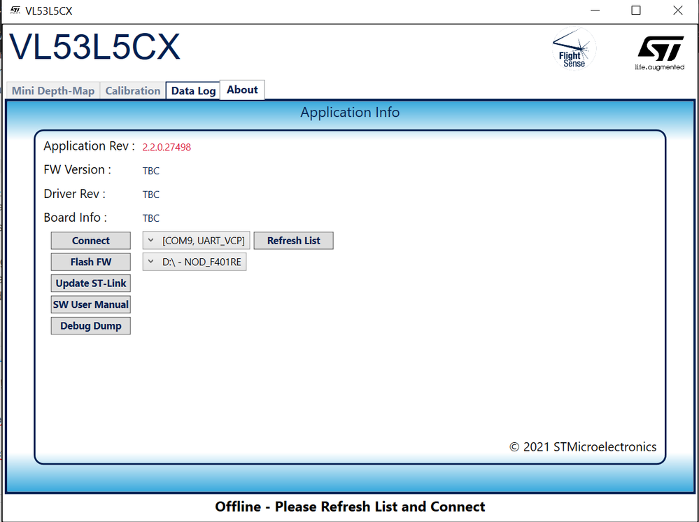

Hello everyone!
I want to connect the STM32F401 + X-NUCLEO-53L5A1 to the GUI and I find the following problem.

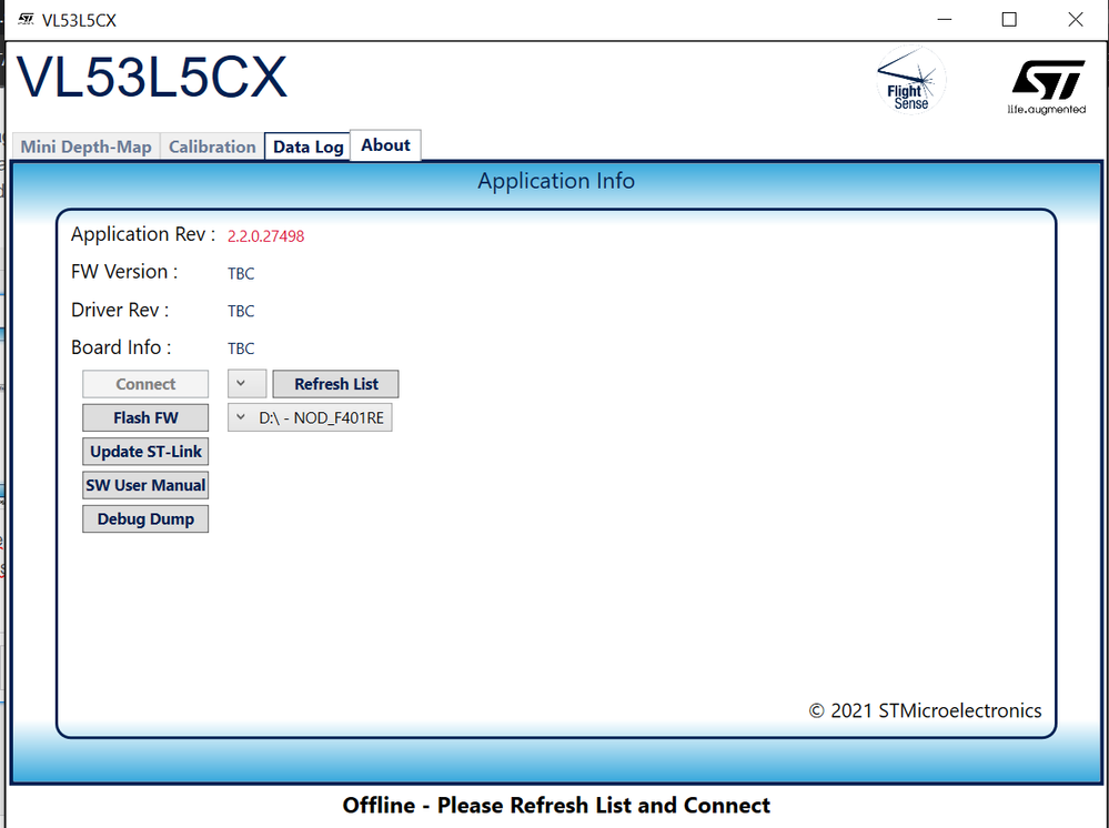

If I only connect the STM32F401 through the USB port, the screen tells me the following:0693W00000UnUcmQAF.pngBut, if I add the X-NUCLEO-53L5A1 expansion board, it automatically stays in this state, without letting me press the "connect" command:
0693W00000UnUdkQAF.pngCould someone recommend me some help?

John E KVAM
When the software sees the expansion board, it wants the code that runs on the STM32F401.
Press the Flash FW button and watch the LED Flash red/green.
Then you can connect. And from there, you can select the Depth Map tab and get started.
