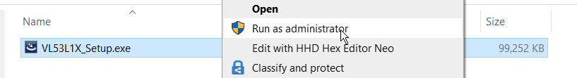

We bought P-NUCLEO-53L1A1 for testing the performance of VL53L1X.
We met some trouble for setup and software installation.
According to the Quick Start Guide for X-NUCLEO-53L1A1), we tried to
install VL53L1X GUI to our PC, but failed. Attached images from C1 to C4
show the process of the installation. We tested the installation in Win7 and
Win10 PC, but all failed.
Could you tell me the reason for the error?

Hi Dai Sai
Unzip the en.STSW-IMG008.zip file then right click on VL53L1X_Setup.exe and choose "Run as administrator". Let me know if it works. Thanks, Julien
DSai.1
Dear Julien,
I did what you suggested, and succeeded.
Thank you so much for your great help.
