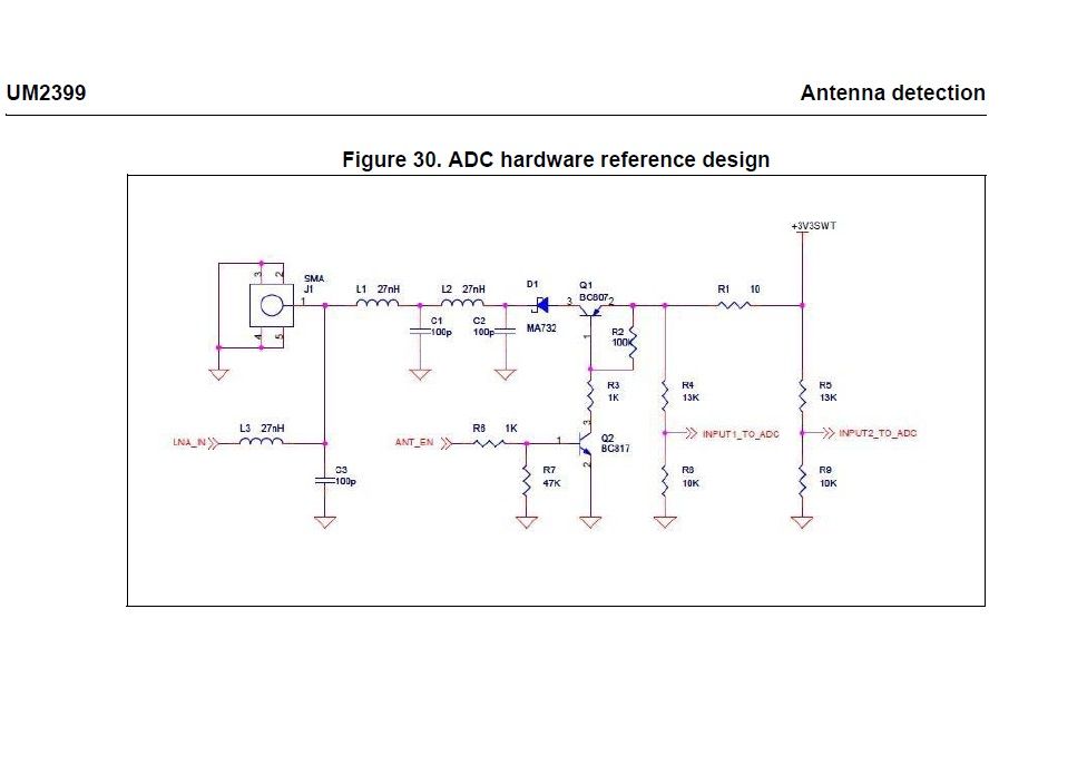

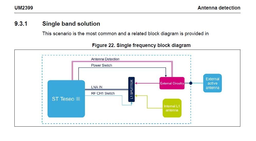

Hi, the user manual of the ST8089FG mentions an internal antenna and splitter but the datasheet does not talk about it, and even if they were external in the ADC hardware reference design the document does not indicates the model of the splitter or the antenna and does not specify if it is a patch, chip, smd, active or passive internal antenna that must be implemented, or when should be implemented, thanks

TeseoIII has no internal antenna and slipper. Both should be part of a board.
but STA8089 is not the right TeseoIII for a low volume project.
Regards
Francesco

Hi, but the STA8089FGBD can be bought from 1 unit in Mouser why do you say it is not the right TESEOIII for low volume project?, I need an IC/module with DRAW that have enought resources to develop an application with its EVB and then make a few PCB boards as prototype
Hi Jairo
I'm sorry for that and I don't know how this product is landed on Mauser...
But it's not a product for MassMarket neither we will provided support, software and reference design for low volume.
Sorry
Regards
Francesco
