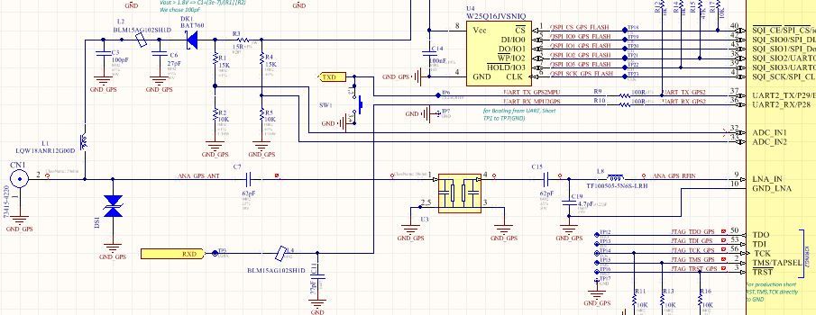

In attach a reference schematic for STA8089GA, it should help.

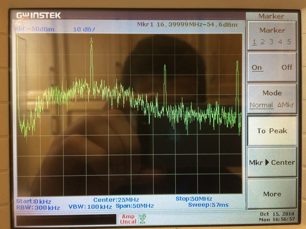

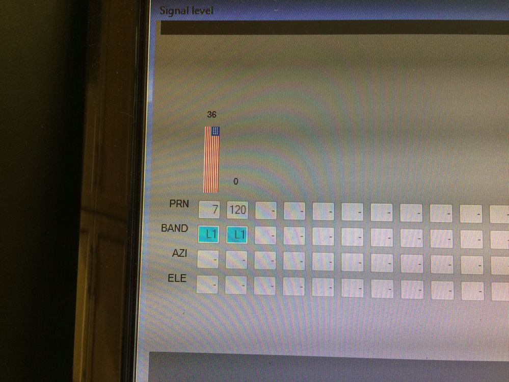

Also I used same schematic you sent. As you said, I used a GPS simulator0690X000006CBV5QAO.jpgThe spectrum Output is shown below
0690X000006CBVAQA4.jpgAs you see, there is no signal around 4MHz (IF frequency). There is just a signal around 16MHz and its harmonics which I don't know where they come from! maybe leakage from PPS. But sometimes the satellite 7 is shown on the software and sometimes not.

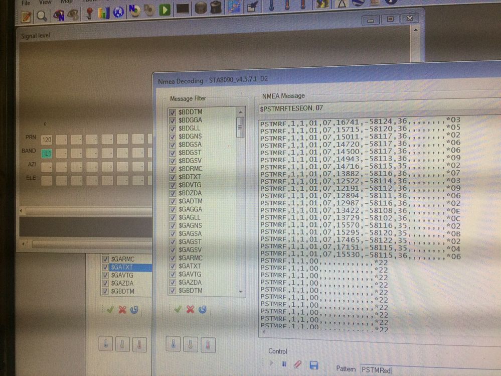

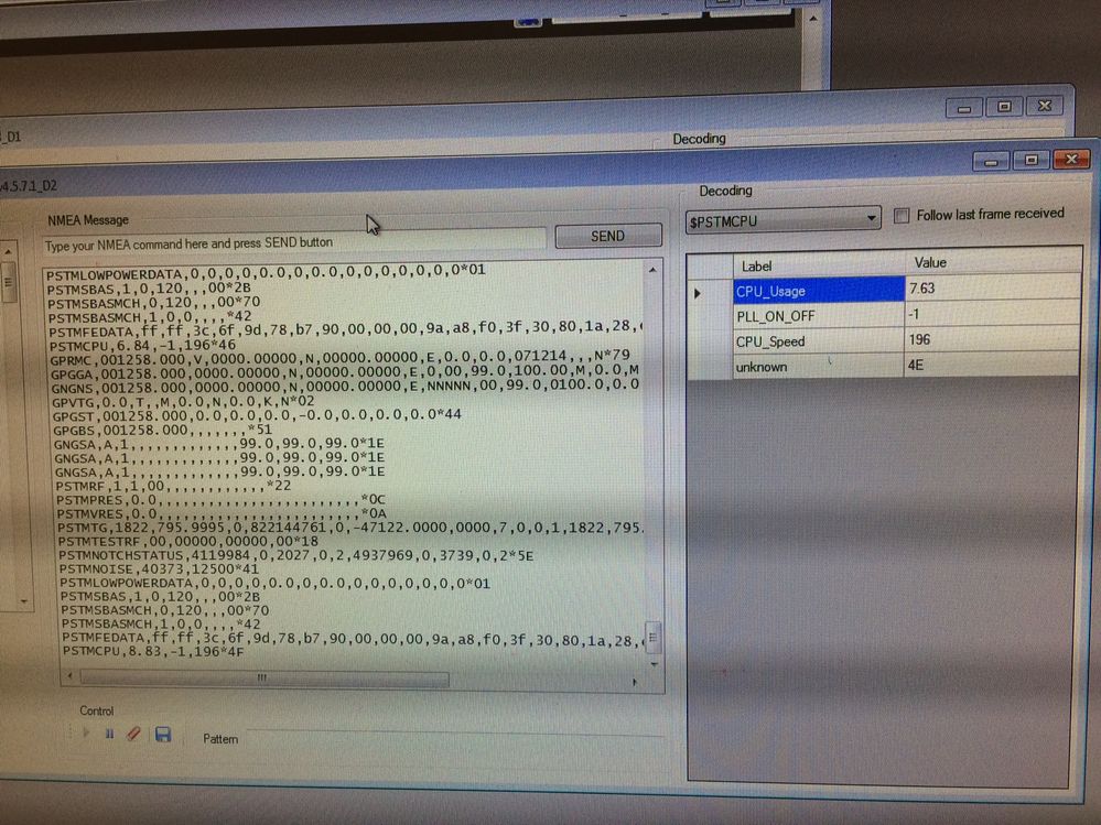

0690X000006CBVKQA4.jpg And something more strange is the CPU usage which never goes further 10 percent (even when the IC detect satellite 7)

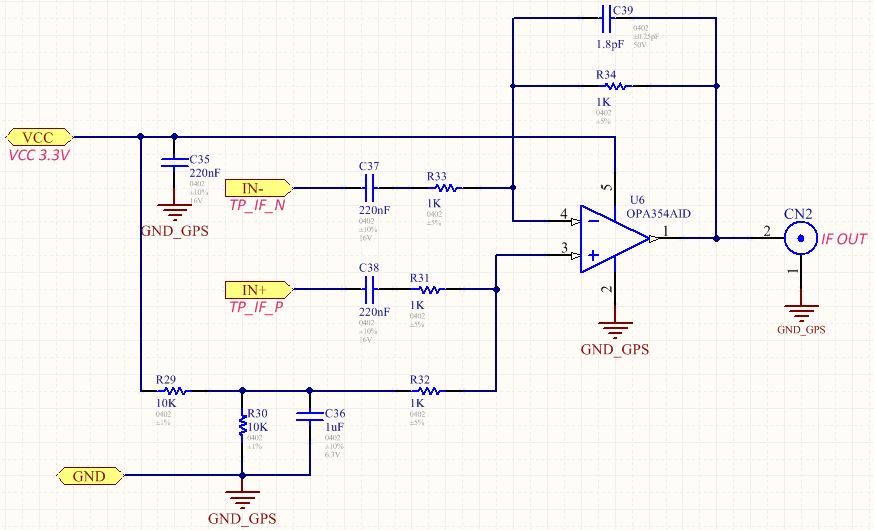

0690X000006CBVUQA4.jpgAs you see something goes wrong in my test bench which I cannot find. I used $PSTMRFTESTON but again nothing was shown at the output of IF pins. Also the differential to single ended structure I used is attached.0690X000006CBVjQAO.jpg

Francesco Virlinzi
Ciao Amir
I assume you programmed the external flash with a Teseo-Binary and you are now running from flash.
The commands as reported in the manual:
"The GPS engine will restart in the RF test modality. This RF test forces the GPS to acquire the process only on the provided satellite’s id"
Sorry but in your schematic the signal coming from antenna (or simulator) has to go in the pad 'LNA_IN'
TP_IF_N and TP_IF_P are for internal usage (left not connected in the schematic)
With the PSTMRFTESTON you can evaluate the CN0 of a specific satellite which gives you a feedback of RF-path performance.
Regards
Francesco

2- In pin by pin guideline it is mentioned |"Pins 5 and 6: TP_IF_P and TP_IF_N: These pins are used only for debug purpose. We suggest to bring out them only for
the first board release ensuring the possibility to check the RF and IF chain (on the RF section) in case of issues. To enable the analog signal output a software command is required (refer to NMEA commands document). An external Differential to single ended output buffer should be needed to interface the system to Spectrum Analyzer. Without these two outputs it is not possible to measure the overall RF/IF Noise Figure for debug and RF matching."
I used IF pins to determine Front-end functionality!
3-The signal coming from Antenna goes to LNA_IN pad (after a SAW filter) in my design too.

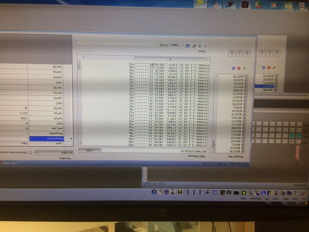

Another question. I set the CN0 of the GPS simulator 40dB/Hz. By using PSTMRFTESTON on satellite 7 sometimes I receive 36dB-Hz and sometimes nothing without doing anything.
0690X000006CBdiQAG.jpgDo you have any idea why this happens?
Also when I connect antenna nothing is received, even not a satellite.

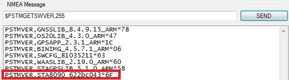

But when I use $PSTMGETSWVER command, I get a weird answer.0690X000006CD0LQAW.jpg
I don't understand why the IC sends back STA8090 (as I said the IC I used is STA8089 GA).

On "STA8090_...622c..." isn't an issue, STA8090 and STA8089 are both Teseo_3, they sit on the same wafer ... they have only package difference.
