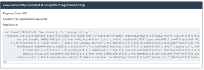

This "Uncaught ReferenceError: MktoForms2 is not defined" means that whatever forms library your website is using is not loading correctly. Looking at the HTML of the page, you can see that this is loaded via a javascript file called "forms2.min.js":
However, if I go to https://content.st.com/js/forms2/js/forms2.min.js I do not get a javascript file, in fact I get the contents of a different file which is more commonly known as a robots.txt file:
Given that this is not javascript. The website breaks. This content.st.com website is presumably part of a Content Distribution Network (CDN) that is used to distribute common files for websites, and it is very likely that you get allocated to a different server depending on where you are on the planet.
I then tried an online HTTP access website: https://wget.alanreed.org/ which I believe is based in the USA to access this same URL:
From this location, the javascript file appears to be served correctly. So it seems that currently your CDN is serving incorrect files to some locations of the planet (or whatever heuristic your CDN uses to select a server). What you need to do is to contact your web team and ask them to please make sure all CDN servers are up to date and not serving stale files.

Thank you! Overnight it seems someone updated the CDN, the javascript file has its copyright date changed from 2023-11-24 to 2024-01-29 and the registration page now works (the javascript errors are gone)! I really appreciate your help on this.
/*! forms2 2024-01-29 See forms2.js for license info */
