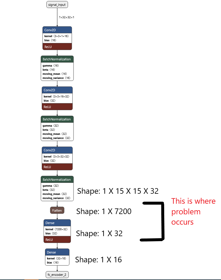

TOOL ERROR: operands could not be broadcast together with shapes (32,7200) (32,)
  • March 16, 2022
  • 14 replies
  • 8742 views
0693W00000Kcsu9QAB.pngI have a convolutional model with convolutional layers bach normalization layers and Dense layers at the end. The model is converted to a tflite model. The inferencing works perfect on computer using tflite but When I try to deploy it on the nucleo h743zi2 I get this error.
The network layers ans its shape look like it is shown in the pic. Has anyone come across this problem?
As far my understanding goes, I did not do wrong model creation. It is some bad interpretation from STM Cube library.
Additional Info: I am using STM Cube AI version 7.1.0
Thanks in advance
Rick
    Best answer by fauvarque.daniel
    The problem comes from the optimization to fold the batch normalization.
    With the undocumented option "--optimize.fold_batchnorm False" the model is analyzed correctly.
    You can pass the option directly to the stm32ai command line or if you are using X-Cube-AI inside STM32CubeMX you can add this option in the first screen of the advanced parameter window
    Regards
    Daniel

    fauvarque.daniel
    March 16, 2022
    Can you share the model so I can reproduce and have the development team fix the problem ?
    Thanks in advance
    Regards
    Daniel

    fauvarque.daniel
    fauvarque.danielBest answer
    March 17, 2022
    Regards
    Daniel
    ​In order to give better visibility on the answered topics, please click on 'Accept as Solution' on the reply which solved your issue or answered your question.

    fauvarque.daniel
    March 18, 2022
    During code generation there is an optimization phase that can merge some layers, a typical case is a Conv2D followed by a batchNormalization followed by a ReLU, The optimized graph will just have a Conv2D
    For example for this part of the model
    0693W00000KdCYTQA3.jpgAfter the optimizer the model will look like
    Regards
    Daniel
