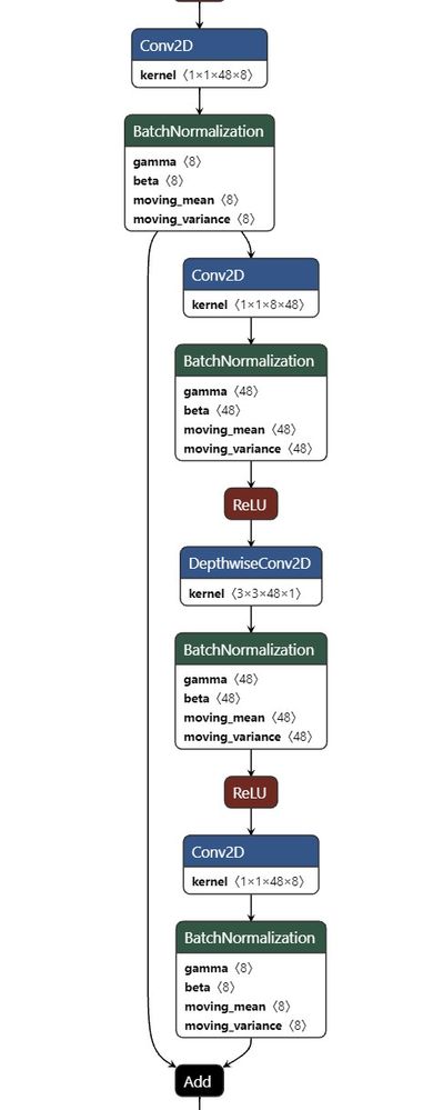

0693W00000Kcsu9QAB.pngI have a convolutional model with convolutional layers bach normalization layers and Dense layers at the end. The model is converted to a tflite model. The inferencing works perfect on computer using tflite but When I try to deploy it on the nucleo h743zi2 I get this error.
The network layers ans its shape look like it is shown in the pic. Has anyone come across this problem?
As far my understanding goes, I did not do wrong model creation. It is some bad interpretation from STM Cube library.

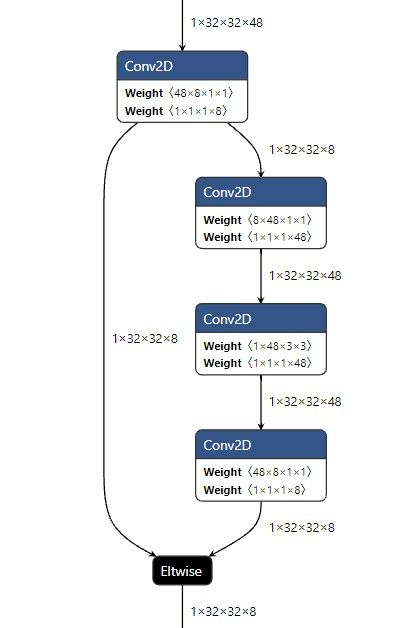

During code generation there is an optimization phase that can merge some layers, a typical case is a Conv2D followed by a batchNormalization followed by a ReLU, The optimized graph will just have a Conv2D
For example for this part of the model
0693W00000KdCYTQA3.jpgAfter the optimizer the model will look like
Regards
Daniel
