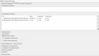

Debug configuration (FSBL project)
I start debugging from the FSBL project.
In Debug Configuration → Startup → Load Image and Symbols, I configured:
  • second_Appli.elf
    • Download = OFF (already flashed manually)
    • Load symbols = ON
So FSBL is loaded/debugged, while App and model are already present in flash.
Additionally, I also tried adding the runtime GCC libraries to the FSBL debug configuration, but this did not change the behavior

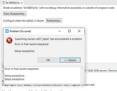

ayaaaa
This is what im getting with the latest configuration that you proposed
