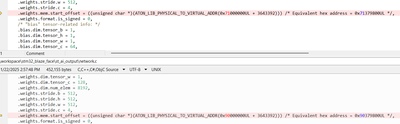

Im trying to use the stedgeai generate command and want to move the data that gets located in the octoflash which seems to default to name=octoFlash offset=0x71000000 at times. Id like to relocate it at another position in the octoflash because i need to run several models. I tried adding the following that I found in an example and the output does not change at all from running it with the following options or not:
--binary --address 0x810000
or
--binary --address 0x810000 --copy-weights-at 0xD0000000
I found these examples via a search but as I said they dont seem to change the output.
What am i doing wrong, I would like to change the default 0x71000000 to say something like 0x73000000, how can i accomplish this? I also tried to just change that in the network.c file, that didnt go well, just locked up the project at run time.

Yes, don't edit the network.c file afterwards, that will cause a few headaches.
Take a gander at the .mpool file under the `Model\my_mpools` folder in the project.
I had to move my region to 0x70680000, and it worked fine.
"fname": "xSPI2",
"name":  "octoFlash",
"fformat": "FORMAT_RAW",
"prop":   { "rights": "ACC_READ",  "throughput": "MID", "latency": "HIGH", "byteWidth": 1, "freqRatio": 6.00, "cacheable": "CACHEABLE_ON", "read_power": 110, "write_power": 400.0, "constants_preferred": "true" },
"offset": { "value": "0x70680000", "magnitude":  "BYTES" },
"size":   { "value": "128",         "magnitude": "KBYTES" }

exarian,
Thanks, I'll give it a try.
exarian,
Looks like that worked, thanks. Have not used on target yet, but sure looks right.
As for you question, not sure of this gets you what you are looking for, but I removed the octoflash section in the JSON file (user_neuralart_STM32N6570-DK.json) and it looks like it defaulted to RAM, 0x90000000 for me
