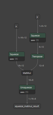

I am trying to convert my Onnx model with the ST Edge AI Core tool to the .nb format for the STM32MP25-DK target.
Since the results were not matching I stripped down the model into the single operations and tried to debug them
It looks like the problem comes from the MatMul operation.
My model looks like this:
When I run my test script were I compare the Onnx model with the NB model, then I get the following results:

ONNX metadata: resources/backbones/op_tests/op_matmul.onnx
INPUT: name=x shape=[1, 16, 12] type=tensor(float)
INPUT: name=y shape=[1, 8, 12] type=tensor(float)
OUTPUT: name=matmul_result shape=[1, 16, 8] type=tensor(float)
Loading NBG model: resources/backbones/op_tests/op_matmul.nb
**Input node: 0 -Input_name: -Input_dims:3 - input_type:float16 -Input_shape:(1, 16, 12)
**Input node: 1 -Input_name: -Input_dims:3 - input_type:float16 -Input_shape:(1, 8, 12)
**Output node: 0 -Output_name: -Output_dims:3 -  Output_type:float16 -Output_shape:(1, 16, 8)
So basically I am only getting 0's after the MatMul.
I already checked that the transpose worked. I verified that the transpose is working and even when I remove the batch dimension with the following model I am getting the same results.

I think that the MatMul-layer should already be supported since it's listed on the wiki page you sent:{524E1D15-C32D-4B9D-A5D5-0B1D09DFBD22}.png
So i am wondering why i get only zeros as a result. Also i don't get any error when converting the model. It seems like there is a runtime bug or that the shapes are maybe not matching. But i could not find any information similar to this one ONNX toolbox support for the MPU.

Hi @NilsW,
We are still checking for the strange behavior.
In this case, the layer seems supported, but maybe a bug.
