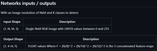

The Input/Output of my YOLO model is Uint8_t/Float, confirmed by checking the value of the Buffer_DataType_TypeDef element in the network instance, which are both supposed to be stored in a single dimension array as suggested by the API.
The output of the model as per the model zoo is (1,4+K,F), with F being proportional to the input image size, in the case of a 256x256x3 image, it's value is 1344.
The value of K can be calculated by the maximum size in bytes of the output located in network.h, making the output (1,5,1344), which in a single array would mean, considering output[] as a float array buffer of the output pointer, with values normalized between [0,1]:

Now for the output of a YOLO Model, the information in the GitHub documentation must be followed:
For a model with a 256x256x3 input layer, the output format can be specified by calculating F.
In this case, N = M = 256.
(256/8)^2 + (256/16)^2 + (N/32)^2
1024 + 256 + 64
Which equals 1344, making F = 1344.
This information means that the output shape of the model will be (1, 5, 1344), you can confirm that your calculations are correct by checking the LL_ATON_DEFAULT_OUT_1_SIZE_BYTES define in network.h, for instance:
My model output values are in FLOAT format, equivalent to 4 bytes of data, which means that my output size will be 5 * 4 * 1344 = 26880, if your define in network.h matches your specific resulting value, your output shape preview is probably correct.
