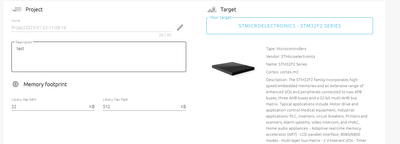

     I attempted to train a model using NanoEdge AI Studio,Some errors occurred!
    first,I create a NC-class project (ps:I haven't connected the development board. I'm just using the computer for simulation.)

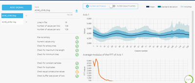

add signal

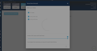

benchmark

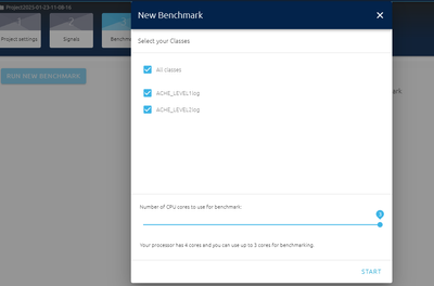

When I clicked "Start," the screen stuck on this page and stayed there all day, only to be closed through the task manager.
What's the problem?

Hello @PP_Developer ,
Everything seems correct at first glance.
Please try to restart your computer to make sure everything related to NanoEdge is closed
Uninstall NanoEdge
Install NanoEdge again.
Sometime, during the installation / update, there are issues due to non-closed elements.
Please keep me updated.
Have a good day,
Julian

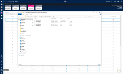

Can you send me the log files in a zip please:
  • Click on the icon as in the screenshot in the bottom left corner.
Network issue may cause error but later in the process.
You don't need permission
As for requirements make sure to have free disk space but that's it...
Julian
This is log.
