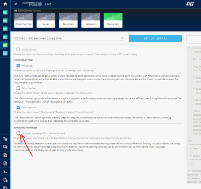

Hello @dw1,
The shape of data you get from the TOF VL53L5CX  is indeed one frame of size 64.
Concerning your other issue. I think you may not be correctly using this function.
In Anomaly detection, you get a untrained library as output of NanoEdge AI Studio.
The steps to use it then in your embedded project are:
  1. To init the library with the init() function
  2. To give the model knowledge (to train it). To do so you have 2 choices:
    1. You can get the "knowledge" from NanoEdge AI Studio, if you load this, you will get the exact same library that you got in the benchmark. To do so, you need to check the option to get the knowledge and re compile the library:
      In the .zip, you will get a new file to add to your embedded project. Finally, you can call the function:
      neai_anomalydetection_knowledge(knowledge)​
      (So to be clear, here you don't use TOF data, you just link the knowledge file in your project).
    2. You can also choose to learn new data instead of using the knowledge. It allows you to get data for the training that are coming from your real final environment. A good example is, let's say, you train a model for a motor, then you want to deploy it on 10 other motors of the same kinds. If you retrain the model on each motor specifically, each model will better fit their final environments.
      To do so, you need to use the function:
      enum neai_state neai_anomalydetection_learn(float data_input[]);​
      For the learning/training, you need to use normal data only. You can create a loop to use this function multiple times (in NanoEdge, you should find the minimum recommended number of learning.)
    3. You can do both, you could load the knowledge of the benchmark and also learn new signals if you want.

Hello @dw1,
Thank you for the additional information.
To use multiples library, you can give them names in the last NanoEdge step:
Then the functions will have a prefixe, like fall_detection_anomalydetection_init().
So you need to give them names, get the new files and uses these new ones in your project.
