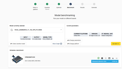

Could you describe a bit what you did exactly? What application are you using?
With the dev cloud, I get 6ms inference time.
To use the NPU, you need to have "--st-neural-art" in your generate command, for example:
stedgeai generate --model model --target stm32n6 --st-neural art
Ini the report, you will see, which epoch layer is in software (MCU) or hardware (NPU).
In the case of this model, I got only EC epoch (epoch controller epochs: multiple hw blocks, for optimization)
Epochs details
Total number of epochs: 106 of which 2 implemented in software
epoch ID   HW/SW/EC Operation (SW only)
epoch 1       EC
epoch 2       EC
epoch 3       EC
epoch 4       EC
epoch 5       EC
epoch 6       EC
epoch 7       EC
epoch 8       EC
epoch 9       EC
Making sure HW is used is important, and another important thing is to make sure that activations fit in internal memeory. Again, in the generate report you can see something like this:
Memory usage information  (input/output buffers are included in activations)
	flexMEM    [0x34000000 - 0x34000000]:          0  B /          0  B  (  0.00 % used) -- weights:          0  B (  0.00 % used)  activations:          0  B (  0.00 % used)
	cpuRAM1    [0x34064000 - 0x34064000]:          0  B /          0  B  (  0.00 % used) -- weights:          0  B (  0.00 % used)  activations:          0  B (  0.00 % used)
	cpuRAM2    [0x34100000 - 0x34200000]:          0  B /      1.000 MB  (  0.00 % used) -- weights:          0  B (  0.00 % used)  activations:          0  B (  0.00 % used)
	npuRAM3    [0x34200000 - 0x34270000]:          0  B /    448.000 kB  (  0.00 % used) -- weights:          0  B (  0.00 % used)  activations:          0  B (  0.00 % used)
	npuRAM4    [0x34270000 - 0x342E0000]:    288.000 kB /    448.000 kB  ( 64.29 % used) -- weights:          0  B (  0.00 % used)  activations:    288.000 kB ( 64.29 % used)
	npuRAM5    [0x342E0000 - 0x34350000]:    432.000 kB /    448.000 kB  ( 96.43 % used) -- weights:          0  B (  0.00 % used)  activations:    432.000 kB ( 96.43 % used)
	npuRAM6    [0x34350000 - 0x343C0000]:          0  B /    448.000 kB  (  0.00 % used) -- weights:          0  B (  0.00 % used)  activations:          0  B (  0.00 % used)
	octoFlash  [0x71000000 - 0x78000000]:    470.355 kB /    112.000 MB  (  0.41 % used) -- weights:    470.355 kB (  0.41 % used)  activations:          0  B (  0.00 % used)
	hyperRAM   [0x90000000 - 0x92000000]:          0  B /     32.000 MB  (  0.00 % used) -- weights:          0  B (  0.00 % used)  activations:          0  B (  0.00 % used)
Total:                                             1.162 MB                                  -- weights:    470.355 kB                  activations:    720.000 kB
Used memory ranges
	npuRAM4    [0x34270000 - 0x342E0000]: 0x34270000-0x342B8000
	npuRAM5    [0x342E0000 - 0x34350000]: 0x342E0000-0x3434C000
	octoFlash  [0x71000000 - 0x78000000]: 0x71000000-0x71075970
In this case, you can see that the activations are all in internal memory and weights are in external memory.
As weights are only read once, it is ok to have them in external flash. But for activations, you will see a big degradation if they do not fit in internal memory.
Doc: Session - ST Edge AI Developer Cloud
Have a good day,
Julian
