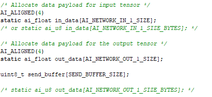

In the code above, in_data is the buffer I used to perform the network inference, I am just assigning values to the in_data buffer like a normal C array (using indices). Let's dig a little bit deeper into the process : 0693W00000BadOXQAZ.pngIn this code sample, you can see how to inject your data into the network and use the inference function "ai_network_run(...)".

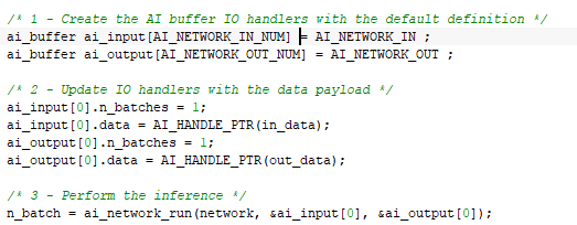

  • First I am declaring ai_buffer array to store input and output data. Those buffers are initialized using AI_NETWORK_IN and AI_NETWORK_OUT C Macros (generated in yournetwork.h file). I am also using the AI_NETWORK_IN/OUT_NUM here to create as many elements as there is of inputs/outputs.
  • Then you need to fill some fields of the ai_buffer array. In the example I am setting a number of batch of 1, and I am specifying also the in_data buffer (the data you want to use) as you can see using the C Macro AI_HANDLE_PTR(...). In this example I have only one input and one output so I only configured ai_input[0] and ai_output[0], but in your usecase you would have to fill the 3 outputs you have: ai_output[0], ai_output[1], ai_output[2]. You can configure each output with AI_HANDLE_PTR using 3 different buffers or you can use a single one using C addresses to separates each outputs
  • Finally once all your input and output buffers a configured correctly you can call "ai_network_run(...)" to perform the inference.
Hope it's clearer ! :)
Romain

You can use the size provided in this file this way:
0693W00000BaXTHQA3.pngIn this example I was feeding accelerometer inputs to the network like that:
0693W00000BaXTRQA3.pngAnd using outputs this way:

Thank you for your reply, but can you explain further what is buffer length and why they need to be incremented when declaring the values for the in_data?
And for multiple outputs, do you have any suggestions as to how the values could be accessed? I am quite new to STM32 so I'm not familiar with how to implement this.
Many thanks

Thank you very much for the added information, I think it makes much more sense now with your clarification and I'm currently getting float values for the outputs.

I have the same question also. My input size as below:-
#define AI_NETWORK_AUDIO_AI_IN_1_HEIGHT   (32)
#define AI_NETWORK_AUDIO_AI_IN_1_WIDTH    (32)
#define AI_NETWORK_AUDIO_AI_IN_1_CHANNEL   (1)
#define AI_NETWORK_AUDIO_AI_IN_1_SIZE    (32 * 32 * 1)
#define AI_NETWORK_AUDIO_AI_IN_1_SIZE_BYTES (AI_NETWORK_AUDIO_AI_IN_1_SIZE * 4)
The size should be 32*32*1. But looking at the application template, it seems like I will need to use (32*32*1)*4. Why do we need multiplication of 4?
jean-michel.d
AI_NETWORK_AUDIO_AI_IN_1_SIZE  indicates the total size of the input buffer in term of number of items/elements. AI_NETWORK_AUDIO_AI_IN_1_SIZE_BYTES  indicates the associated size in bytes. I suppose in your case that the type of data for the input is float, this explains the 4 ( = sizeof(float)).
AI_NETWORK_AUDIO_AI_IN_1_SIZE_BYTES  can be used to allocate or to define the input data buffer to store the input data.
