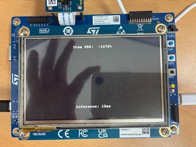

I've tried several models provided in STM32 ai model zoo. I'm wondering why some models does not show the acceptable accuracy. My test results are as follows.
efficientnetv2/Public_pretrainedmodel_public_dataset/ImageNet/efficientnetv2b0_224/efficientnetv2b0_224_qdq_int8.onnx  --> Not Good
mobilenetv2/Public_pretrainedmodel_public_dataset/ImageNet/mobilenetv2_a100_224/mobilenetv2_a100_224_qdq_int8.onnx -> Good
mobilenetv2_pt/Public_pretrainedmodel_public_dataset/ImageNet/mobilenetv2_a100_pt_224/mobilenetv2_a100_pt_224_qdq_int8.onnx -> Not Good
resnet50v2//Public_pretrainedmodel_public_dataset/ImageNet/resnet50v2_224/resnet50v2_224_qdq_int8.onnx -> Good

As you might know, the inference result is keep changing when using camera module. So I decided to embed an image file to test the several models. I used two images for testing. One is banana and the other is daisy, which are attached in this reply.
The inference code is from https://github.com/STMicroelectronics/STM32N6-GettingStarted-ImageClassification, v2.2.0 and when generating network.c, *.h, and *.raw file I used STM32AI-MODELZOO-SERVICES v4.0.
I've attached my yaml file, where only model_path changes according to the onnx file that I want to use.
I've tested 5 models and the results are as follows. All the models are about ImageNet.
  BananaDaisy
efficientnetv2efficientnetv2b0_224_qdq_int8.onnx88%72%
mobilenetv2_ptmobilenetv2_a100_pt_224_qdq_int8.onnx>1000%>1000%
mobilenetv2mobilenetv2_a100_224_qdq_int8.onnx100%96%
resnet50v2resnet50v2_224_qdq_int8.onnx100%96%
mobilenetv4mobilenetv4small_pt_224_qdq_int8.onnx<-2000%<-1000%

Yes, the dataset used for quantization can impact a lot. We internally used a small subset, and this can be quantized differently with the quantization service, starting from the pre-trained model for instance.
I am not sure to understand your table with the % of accuracy using only one image. You used the camera on one  printed image?
I know that the quantization might deteriorate the classification performance. But I am afraid that the accuracy rate should not be over 100% or under 0%.
For my testing, I directly copied the bmp image data to the input buffer (stai_ptr nn_in) before running inference. I didn't use the streaming data from the camera module.
Laurent FOLLIOT
Yes fully agree.
Where do these numbers come from? A log file or on the terminal or printed on the screen of the device?

OK I see.
Shared Onnx models from from pytorch (with _pt in their name) don't have the softmax at the end, so output is not a probability.
This doesn't change the ranking but you can't interpret the output as a probability...
