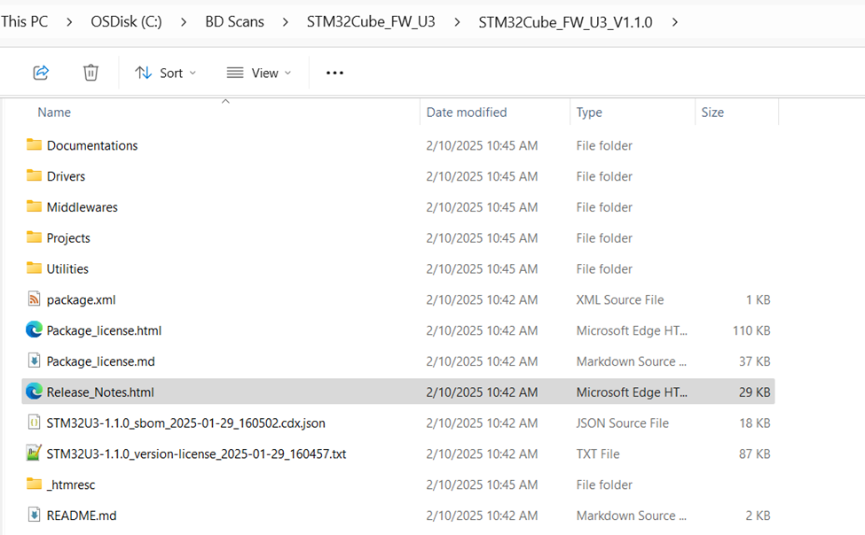

To assist developers, STM32Cube now provides machine-readable SBOM documents, generated using BlackDuck® tools in the CycloneDX format and delivered under a .json unique file available for most software package.

The first package proposing this SBOM in CycloneDX format is the STM32CubeU3 available for download on www.st.com.

I am working with STM32H5 but I had a look at the cdx json file contained in STM32CubeU3 version 1.1.0 as I assume that the setup for STM32CubeH5 will be similar once it is released including an SBOM.
From a quick glance, my conclusion is that the SBOM contains entries for what is included in the STM32Cube package - threadx, mbedTLS, CMSIS, ….
