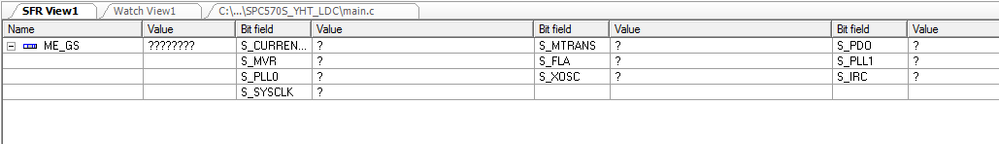

I already entry the STOP mode however the board does not wake up from STOP mode. The program seems to be halted and then showed a warning like this picture.
The mode is then unidentified.
