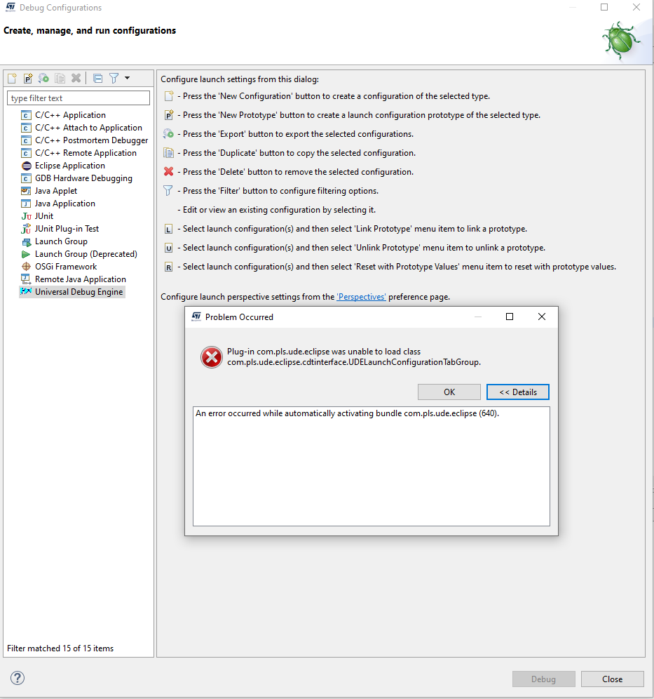

I couldn't find how to add UDESTK's debug screen to my SPC5, can you suggest me the correct way ?

Hello ,
SPC5Studio 6.0 is a 64bits Version based
and PLS UDE Plugin Eclipse based is a 32 bits. (not compliant)
there is a change request in PLS side to provide a 64bits version.
it is still ongoing.
Best regards
Erwan

2021-11-25 06:11 AM
when I did what did you say, it s opening UDESTK but still working on own app, not in SPC5. how can I combo them on SPC5 ? if I try add new debug profile, it s show "Plug-in com.pls.ude.eclipse was unable to load class com.pls.ude.eclipse.cdtinterface.UDELaunchConfigurationTabGroup.
An error occurred while automatically activating bundle com.pls.ude.eclipse (640)."
please show me a solution.

Hello ,
Best regards
Erwan
