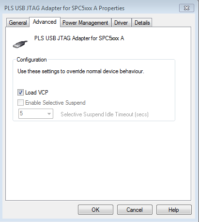

About Jumper, you can use :
if you want to communicate with UART via FTDI .. you can enable VCP in Windows Drivers.
Best regards

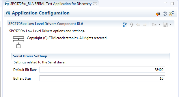

I have found the bau rate is 38400 definded in the lldconf.h, and i am able to get the data by connecting the TX from JP4 to Raspberry Pi 3 GPIO15 (PIN ♯ 10).
By the way, the SERIAL_BUFFERS_SIZE is set to 16U, i wish to increase it, but the value was restored back to 16U after i compile it, so where is the place to change the configuration?

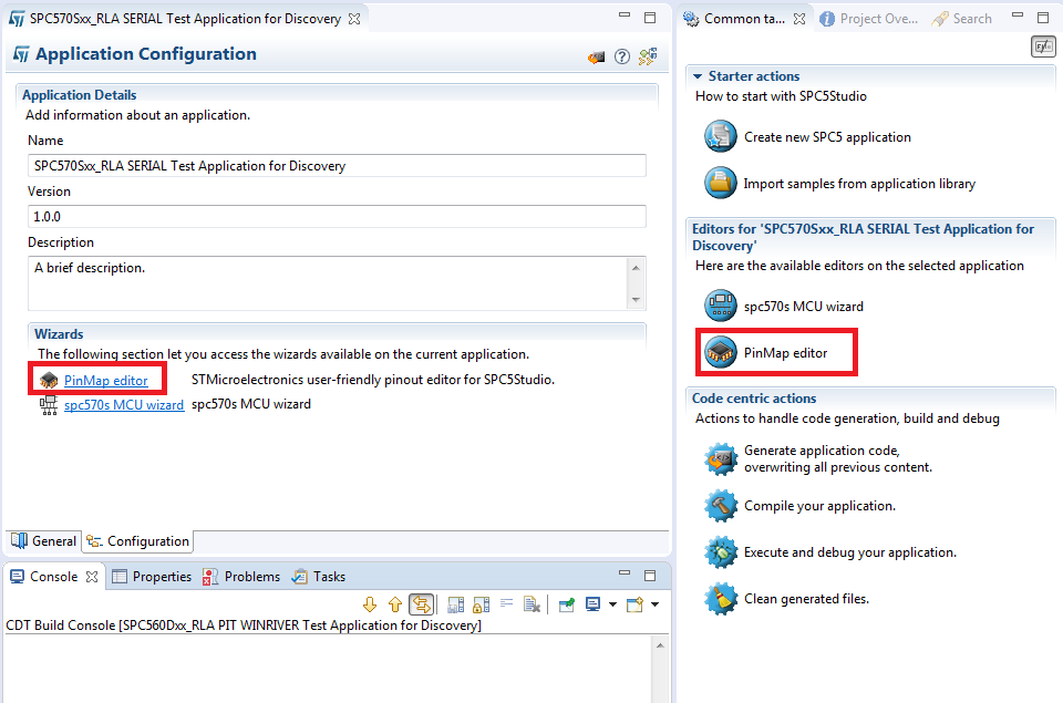

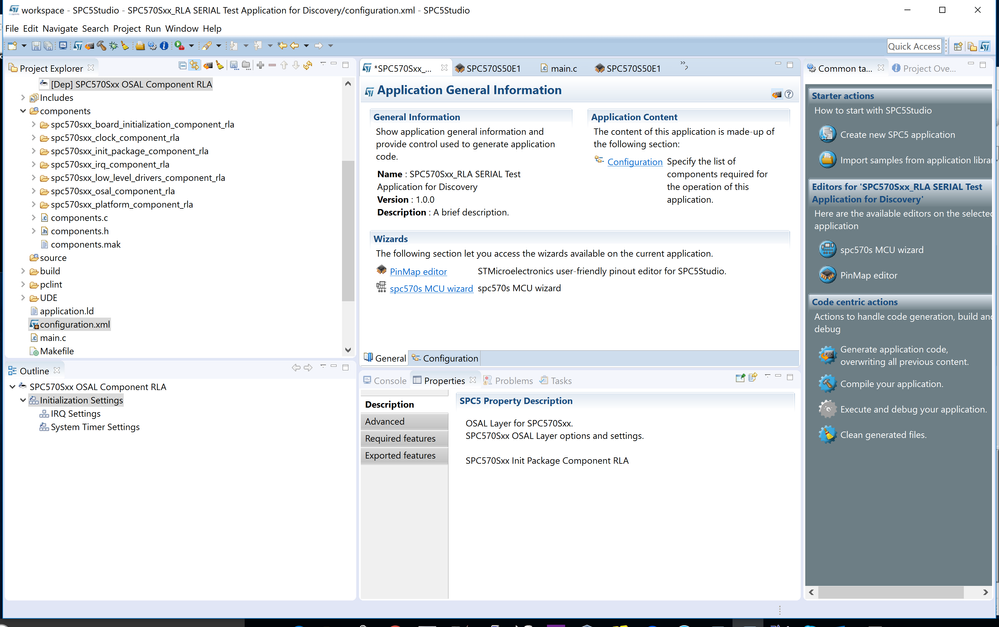

Hi Erwan,
There is no Pinmap Wizard, release notes 5.6 seems suggest pinmap wizard is for selected customer. Does it mean the SPC570S-DISP doesn't have it? Or where can i find it?
see screen shot.
Best Regards,
Job
2017-12-01 1:59 AM
Hello Job ,
The Pinmap Editor is for everybody.
it depends on the family used
please click on this following button
Cf help Section , the BUFFERS_SIZE is set in the components.
all the cfg directory is generated from your configuration component.
Best regards
Erwan
2017-12-01 11:57 AM
Hi Erwan,
Thanks for the info.
Sorry i didn't make my question clear, you mentioned '
Please check the Pinmap Wizard and the Pin configuration.', and i thought Pinmap Wizard and Pinmap Editor are two different things. I do see Pinmap Editor, but Pinmap Wizard is nowhere to find.
I am able to find the Serial Driver Settings configuration, that is great.
Best Regards,
Job
2017-12-04 3:43 AM
Sorry for the misunderstanding, Pinmap Wizard is the Pinmap Editor
you can use the output formatter
there is some practical functions to scan or print using emulated C Functions (printf and so on ..)
Best regards
Erwan
