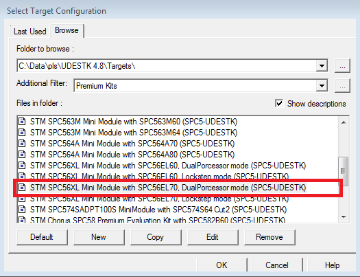

SPCSetRunMode not return ......
board:
Discovery Plus Kit for SPC56 L line - with SPC56EL70L5 MCU
my step:
file->new sp5 studio Application wizard->
select
click generate button and click build button
program FLASH and debug...
Has been parked here....
I didn't changed any code...
Solved! Go to Solution.

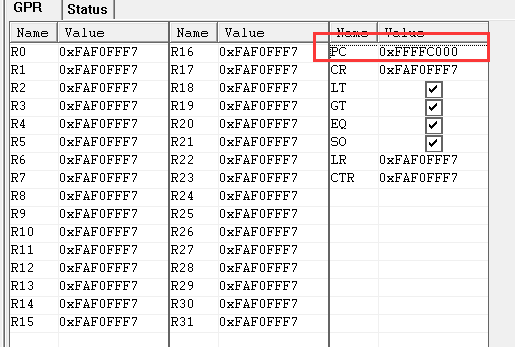

2017-04-14 6:00 AM
1.Disconnect
power and debugger ,
2.
connect power
again. app can not run.
This image represents the value of the PC when the program is not running

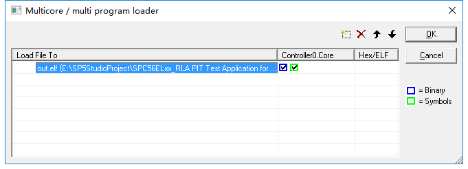

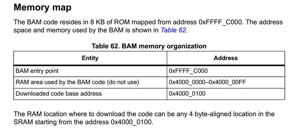

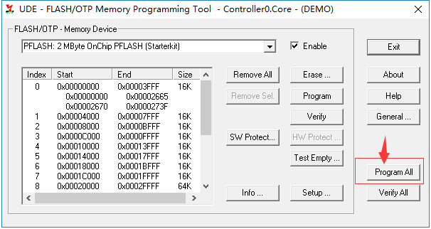

Hello Guo ,
i am still waiting your Installation details
The hardware has not found a valid Boot ID in any flash memory boot locations
the device is fetching the code 0xFFFFC000
You have not flash the firmware, please flash the firmware by using LOAD PROGRAM in PLS
Anyway, for your information , SPC5Studio 5.3.0 is available.
You can update by Update site or Marketplace
we have corrected all the debug.wsx (it is compliant for PLS 4.8.2)
Use PLS 4.8.2 for to debug and flash.
Best regards
Erwan

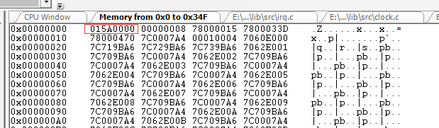

2017-04-17 3:52 AM
I do through the '' load Program steps '', download the Program.
After Disconnect 12V power , after a while....
I connect 12V Power and debugger.
look the memory dialog
the memory address 0 value is 0x015A0000.
the pc value is 0xFFFFC0000
My PLS version is 4.8 demo verison. no input license.This causes?
2017-04-17 7:01 AM
The problem has been solved.
PA4 connect to GND. connect 12V power again.ALL GOOD~

.2018-01-22 2:03 AM

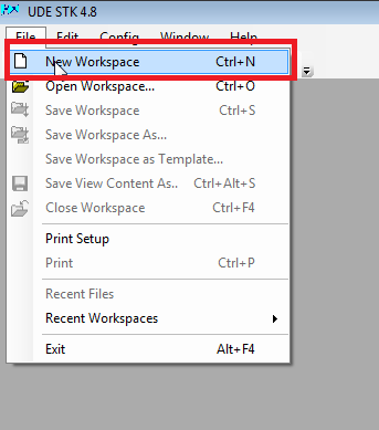

I had this same issue, but it really had to do with the fact that I had older debug.wsx that didn't match the software version for the PLS I was using, which was 4.8.2. Ensure that your PLS is updated and that SPC5Studio is updated (.wsx that came with 5.7.1 is aligned with PLS UDE 4.8.2).
2018-01-24 1:42 AM
Hello Matthew ,
You can recreate a debug.wsx from scratch by using new workspace in PLS UDE.
Anyway, if you have an crash issue after configuring your clock.
i recommend you to check R13 and PC in the Core registers.
it will give a nice a nice clue where the problem happenned.
