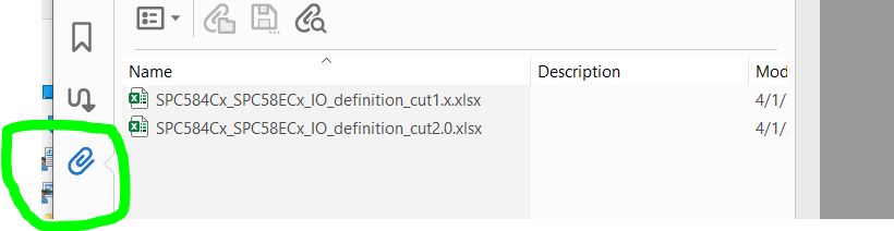

Hi, where can I find microcontroller pinout?
I miss something? I can't find spc5 pinouts in datasheets, where are these resources?
Best regards
Solved! Go to Solution.
2022-02-27 1:42 PM
for each SPC5 MCU pinout description is available in a specific technical note.
See the MCU specific documentation page.
For example, SPC58EC pinout is available in Technical Note TN1260 (link)
Download the MCU specific I/O definition technical note, it is in pdf format,
then the I/O pinout file is attached to the pdf as spreadsheet file.
Regards.

2022-02-27 2:13 PM
thanks, opening the pdf from the browser it is not possible to see attachments and therefore I could not understand where they were.
2022-02-27 2:18 PM
please do not open the file in a browser, download it instead.
Open with a pdf viewer, for example Acrobat Reader
Open the left menu and click on the paperclip.
