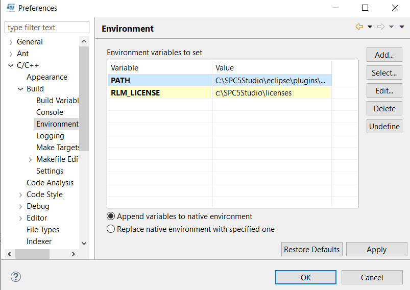

Hello everyone, I'm working with SPC5Studio v5.0.
I need to  make permanent changes to the values of the environment variables (see picture below):
Unfortunately, every time I make a change it only last until the next restart of SPC5Studio (e.g. I change the RLM_LICENSE value to have it pointing to a local license server, and when I restart SPC5Studio I find it reset to the default value C:\SPC5Studio\licenses).
Furtermore I'd like to add the files where these variables are stored to my repository, so that they can be part of the commit. Where do I find these files?
Thank you.
Regards.
Alessandro

Erwan YVIN
Posted on June 14, 2017 at 14:31
Hello
Alessandro ,
Permanent change does not work on RLM_LICENSE
just for the others environment variables
I have submitted an Error Report / or Change request in our bug tracker.
Please use the directory c:\SPC5Studio\licenses
    Best regards
