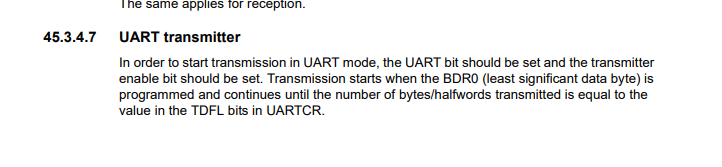

I do not see any clue except the chapter 45.3.4.7 UART Transmitter from RM SPC582Bx (i assume)
on BDR0
0693W00000GY1KYQA1.png Best regards
Erwan

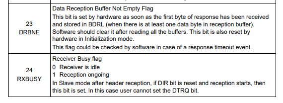

I see only the check on this flag (RXBUSY)
if RXBUSY (1), Reception is ongoing then started ;)
0693W00000GY1XwQAL.pngor maybe RDI Flag.
